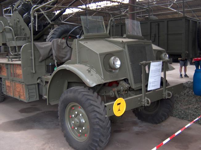

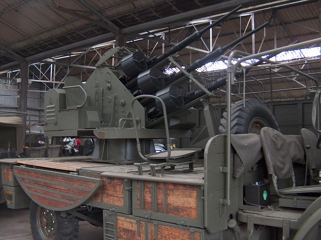

See Depot Kapellen, 250606 for a picture of the surviving Ford F60L with triple Polsten AA guns. It is owned by the Brussels Tank Museum, but held in their depot at Kapellen, Belgium. As far as I know this is the only remaining example of this type.
If anyone has further info about its design, manufacture or use, please post here.

I was at the depot last sunday.
What I heard was that the polsten and rear were not original, but were mounted ater. The chassis and cabine are original. Unfortunately I forgot to photograph the informationsheet of the Ford.

Here are some of the pictures I made of this truck in 2004. For more large size scans see my G503 album.
Build date 1946 - that is surprising, eh? Who knows what R.O.F.H. stand for?
Royal Ordnance Factory - Hooton (Cheshire) ?
Factory No.10 incidentally.
R.
