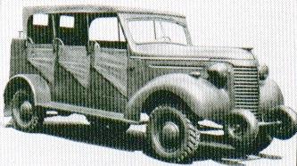

Default ford 4x4 commandowagen met winch
Now we're at it: here is another one:
From the same old article by Claassen (Mars et Historia) that came up with the Maple Leaf tractor. It is a 4x4 Ford commandowagen with winch, that according to Claassen came available after war broke out (so after dec 1941). If this is true, where was it ordered? The commandowagens served with the artillery battalions and possibly in other units.
Hanno, might this be a Marmon-Herrington delivery?
Enjoy.
Nuyt

Nuyt:
Can you rescan that one again?
My thought would be it is a MH chassis with local bodywork possibly.
They did an awful lot of this type of vehicle prior to 1941 for the US, Belgium, Holland and I am sure some others.
That appears to be a "terrain roller" on the front, did it have a winch mounted there or elsewhere also?

Hi Bill, here is another scan (it is actually a scan from a fotocopy, so there are some limits to quality...)
You are right about the terrain roller, there is no visible winch on this particular vehicle. Was it at the rear?
The roller makes it I think definitively a US-sourced vehicle and not a DAF pre-war conversion. Also the body style/cover make it different from Dutch-sourced Fords. (and those would have had to be delivered/shipped before May 1940).
Checked Bart Vanderveen's directory and p 334 shows a Ford11Y/MH (albeit as a Bomb service truck) which was a 1941 commercial chassis.
Probably a cash paid direct Netherlands Purchasing Commision order to MH...Hanno?
Oh, I forgot: it seems to be a rhd vehicle. Did MH do that?
Kindest regards,
Nuyt

Hej Nuyt:
Methinks Hanno or David are a little better equipped than I on this one. I have more questions than answers it seems.
Anyway, yes MH supplied RHD on a great many contracts. I cannot find my written research files just now but I believe that they either had a Canadian subsidiary or purchased the chassis from Ford or GM or whomever from their Canadian operations.
This one is baffling in that it is obviously a 1941 model, hence it was not bodied in Holland. At the same time, I have no photos of that particular body in my MH collection so I am presuming it may have been done in NEI. It is not really a MH "style".
Then, the over large wheel/tyre equipment leads me to believe it is at least a one tonner, not a 1/2 tonner as most of these command cars were.
I have not seen this vehicle before, thanks for bringing it back from oblivion, Nuyt!
As stated, this is a 1941 model Ford, and thus could not have been shipped from the Netherlands - it must have been converted by Marmon-Herrington in the USA. The front roller is typical for US vehicles of the early war period (M3A1 Scout Car and Half-Track vehicles).
But, if you compare it with the 1940 Chevrolet/DAF Pantserafweer-geschut (or PAG) trekker (anti-tank gun tractor) shown below, I draw the conclusion that it was converted along the lines of the conversion DAF carried out on Ford and Chevrolet chassis/cowls before WW2. I can only imagine the NPC taking the blueprints to M-H to order a batch to be built along DAF's design as far as practical. Take a 1-ton right-hand drive chassis/cowl converted to all-wheel drive, add a simple open-top body with canvas overhead cover, three rows of seats for the 6-man gun crew plus driver, an ammunition locker at the rear, and add a front roller instead of the two small wheels - order filled!
Do we have any clue how many of these were converted?
(Source: http://www.autogallery.org.ru/gdaf.htm)

Hanno, the 1941 Ford Commandowagen looks definitely inspired by the DAF light AT tractors. But where were they ordered/built:
- in Australia on Ford/MH chassis...
- in Canada or
- in US with MH?
What we need is a detailed order list of what the Dutch ordered at MH, but where do we get it?
Btw: Wheels and Tracks 74, p 23 has your DAF picture mirrored (actually showing 4 similar vehicles) with the following caption:
"Some of the Chev light AT tractors were equipped with 4wd, front support wheels and other options. They were probably destined for the NEI but we have no pertinent information on this or on their eventual fate"
I vaguely remember having seen one DAF trekker in the Command Car role on a picture of a KNIL parade, but am not sure.
Total numbers of these Command Cars?
If it was an artillery battery staff car and there were 3 batteries in one KNIL MOTORISED art. Afdeling or Battalion of which there were 1 Howitzer, 2 Field, 1 Mountain (the other Mountain Art. Battalion being probably non-mech) in Java:
a grand total of at least 12!
Not counting extra batteries formed as war neared, AA battalions, the Madoera Mobiele Stelling Artillery Battalion, the (mainly non mechanised) art. units on Java and other islands and any other units (Infantry Battalions?) that might have wanted them...

I wonder whether these were sourced originally from Ford of Canada as they were rhd? They seem to have had a monopoly on rhd Ford export chassis. I will ask my pal Norm Darwin if Ford of Australia at Geelong exported any vehicles to the NEI.
