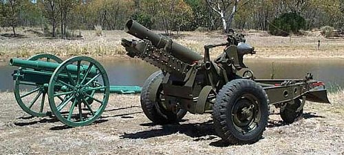

As far as I know, the Short 25-pdr gun was an Australian pack gun version of the British 25 pounder gun/howitzer, developed as a result of experience in the jungles of New Guinea indicating the need for really portable artillery. First produced in 1943, it was a shortened version of the standard 25 pounder, mounted on the Carriage 25-pdr Light, Mark 1. The "Baby 25-pdr" was intended for jungle combat and was used in Southeast Asia and the Pacific, during World War II. The gun could be towed by a light vehicle or broken down into sections, capable of pack transport.
The only resemblance to the 25pdr was the breech mechanism, recoil system, cradle and sights. The trail was simplified, wheels made smaller, and castor added to the end of the trail for easier manhandling. The shield and and platform were discarded, and a heavy spade added to anchor the gun while firing. The gun itself was drastically shortened to 46.69 inches, and a muzzle cap added, which gave a total length of 63.79 inches. Broken into 14 packs the total equipment weight was 3,015 Lbs. It could not be used with supercharge, so the maximum range was only 10,800 yards.
Shown below is a survivor, ex-Rod Keys, now in the collection of the Meandarra ANZAC Memorial Museum in Australia.

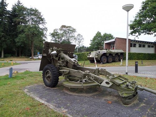

Now, what type of 25-pdr is this? The carriage has a narrowed axle, matching smaller diameter firing base, narrowed shield and folding trail. Is this the Airportable/Airborne version?
http://www.ktr.nl///fotoalbum/veluwe/veluwe1.jpg
Source: http://www.ktr.nl
I'd like to learn more about it, as the Netherlands Army has had quite a number of them in use. Next to the one shown above, there at least two more of these 25-pdrs existing (although at least one of them is a bit of a mix 'n match).
Old 16-08-05, 17:38
Mark W. Tonner's Avatar
Senior Forum Member
Posts: 3,026
Hi Hanno;
I'm no expert on the 25pdr, but from your description; the gun is mounted on a modified Mk II or Mk III carriage, with the smaller No. 22 platform. The only 25pdr that I know of that was used in the Airportable/Airborne role, was the Australian Short Mk I, in the Pacific Theatre. In NWE/Italy, the American 75mm pack How. was used.
Mark

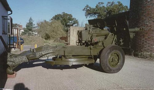

Hanno,
I restored one of these for the Royal Artillery Firepower Museum at Woolwich, London. They know it as the "Jungle 25 pounder". It has a narrower axle, smaller diameter platform (to suit the narrow axle) and folding trail, other than that it is basically the same as a normal 25 pdr.
The folding trail is nothing to do with airportability, it increases the elevation when operating in jungle or hilly situations. The barrel length is same as norm as well. If I can find a photo of it, I will add it to this thread.

Hanno,
according to the 1957 user handbook, there were 3 types of carriage in service;
Mk.1, the original WW2 carriage
Mk.2, converted from Mk.1 by narrowing the trail, the shield, and the firing platform, to enable the gun to be towed by a light vehicle ( probably LWB Land Rover). The trail eye was fitted into a bracket which could be swung up or down, up to avoid the ground on firing, and down to raise the spade for towing (the L.Rover towhook is much lower than the limber's).
The two hinged flaps at the lower corners of the shield enabled drag ropes to be attached to the drag washers on the hubs. Even the traversing gear handwheel was made smaller and lost the handle to avoid fouling the tyres.
Mk.3, similar to the Mk.2, but with the addition of a 'knee joint' to lower the carriage to enable the gun to fire at higher angles of elevation ( 55 vs. 40 degrees ).
A dial sight carrier adapter was used to bring the dial sight back to horizontal when the carriage was lowered for high angle firing.
Amendment No.3 of May 1960 instructs users to delete references to the Mk.2 and Mk.3 carriages, indicating that they had been withdrawn from British Army service.

Old 16-08-05, 23:36
Posts: 13,310
Default Re: 25 pr
Mark, Richard, thanks for the info. Found the following listed on Jedsite:
25-pdr Mk II on carriage 25-pdr Mk II - Narrow carriage version for jungle and airborne operations.
25-pdr Mk II on carriage 25-pdr Mk III - Hinged trail version for use in mountainous terrain.
More info and pics are welcome!

Old 17-08-05, 00:12
Posts: 3,580
"A narrower and lighter carriage was also developed for use in jungle warfare, this was known as the 25-pdr Mk 2 with Carriage Mk 2. A hinged trail model was also developed for mountain warfare to give increased elevation (25-pdr Mk 2 with Carriage Mk 3)."
Hanno,
The picture is of the type I described. The front sheild was of normal width and draught eye was no different either.
From AWM:
ID Number: 083750
Summary: TRINITY BEACH, QLD. 1944-11-27. 2/5 FIELD REGIMENT TROOPS TOW A SHORT 25 POUNDER GUN HOWITZER WITH A NO. 3 GUN TRACTOR TO A DUKW AMPHIBIOUS VEHICLE FITTED WITH AN 'A' FRAME. THE UNIT IS ENGAGED IN EXERCISES WITH 1 COMBINED OPERATIONS SECTION.
Old 19-10-05, 17:46
Posts: 13,310
Default Re: 25-pdr Short Mk I (Aust) or "Baby 25-pdr"
Another survivor in Australia (source: http://members.tripod.com/stall-chan...-change-page-7).
Richard,
So sorry to drag up this old thread but did you ever find the pictures of the gun you restored ? I am trying to determine the shield configuration between the two modified 25 pdr's.I know one had the extra flaps in the shield in front of the wheels for the drag ropes and the other without ?
Rob...............rnixartillery.

Old 06-12-14, 20:47
Posts: 3,580
Hi Rob,
The only photo to hand at present is this one on my web page, I hope you can see the detail on it. Click on this link:
http://www.milweb.net/dealers/trader...orations/f.jpg
regards, Richard

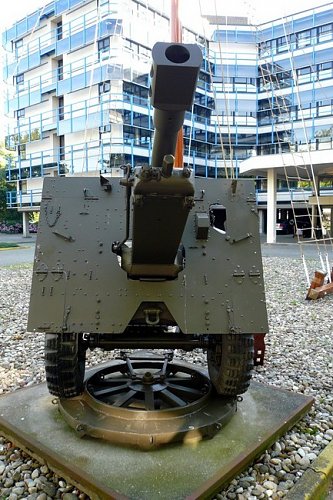

Old 06-12-14, 23:18
Posts: 13,310
Rob,
If you need pictures I can post some more of this gun I photographed recently.

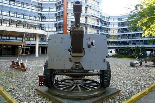

Old 07-12-14, 10:37
Posts: 13,310
Richard, So sorry to drag up this old thread but did you ever find the pictures of the gun you restored ? I am trying to determine the shield configuration between the two modified 25 pdr's.I know one had the extra flaps in the shield in front of the wheels for the drag ropes and the other without ?
Don't be sorry, it's about time this thread was refreshed!
That one shown on Richard's site seems to have the standard width shield instead of the narrowed one. Result of a mix & match of parts during a rebuild program?
For comparison here is a front view of regular 25-pdr shield (left) and the narrowed one on the Mk.2 and Mk.3 carriages (right):

See more and larger pictures of these two 25-pdr guns in my G503 album >> 25-pdr.
