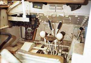

Detail
of the driver's station viewed from the turret. The seating position is
much like a race-car, with the driver's legs slightly raised. It is tight,
but surprisingly comfortable. The 'V'-shaped black-handled levers are the
tiller bars. Gear shifter is on the right, and instrument panel on the
left. At the top of the picture are the twin periscopes which comprise
the only visibility when buttoned down. |
