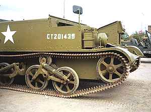

UC Mk.II* #2 A front quarter view showing detail of the spare bogie stowage, as well as the POL container and blackout lamp. Note the lack of steel step on this side, and the 'non-stock' mirror. Originals are hard to find. The MkII has a folding armoured flap at the top of the commander's position, above the slot for the Bren/Boys/PIAT.
UC Mk.II* #3 Frontal view from the right. Carrier track is the ultimate in simplicity. A new track has 168 links, and wears in with the sprocket; when it's down to 158 links, one replaces both the track and sprocket. The trouble is, there's no more new track! Current owners make do by limiting mileage and driving carefully. Perhaps one day we can have some made...
