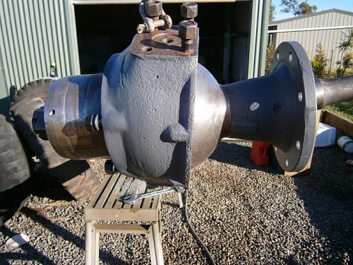

Yesterday, I got the diff carrier bearing cups out of the casing halves. Well, my father-in-law did the required welding, I just pulled the cups out once cooled. The case is now ready for painting. The second of the steering knuckles got it's coat of etch this afternoon. I would have gone ahead with the painting today, but it was far too windy, or more to the point, wind direction was constantly changing. I only wanted to paint the truck parts, not our weekday car or the neighbour's, so no top-coat today.
Name:	front axle halves primed 1.jpg
ID:	57330 Click image for larger version
Name:	front Dside steering joint primed.jpg
