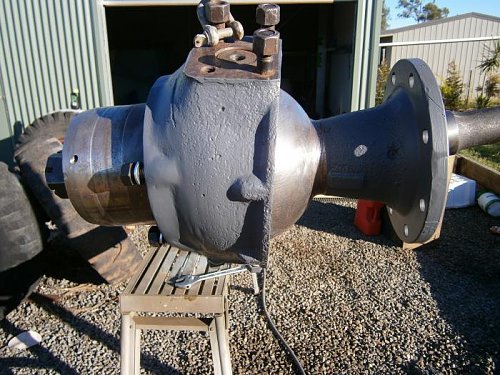

Yesterday, I got the diff carrier bearing cups out of the casing halves. Well, my father-in-law did the required welding, I just pulled the cups out once cooled. The case is now ready for painting. The second of the steering knuckles got it's coat of etch this afternoon. I would have gone ahead with the painting today, but it was far too windy, or more to the point, wind direction was constantly changing. I only wanted to paint the truck parts, not our weekday car or the neighbour's, so no top-coat today.
Name:	front axle halves primed 1.jpg
ID:	57330 Click image for larger version
Name:	front Dside steering joint primed.jpg

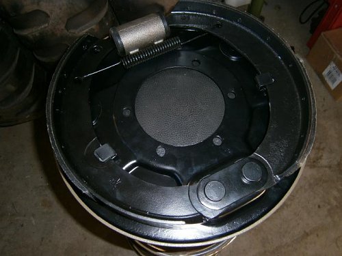

Got further with one of the brake backing plates, which now has the full system installed, with one exception, I don't yet have two new banjo bolts to attach the new brake hose/s. I get those Monday afternoon. I need to buy one of the brass cams that are used for adjusting the lower end or brake shoes. Looks like the former owner wasn't good with keeping his parts in the one place! I did find the required brake retracting springs though. With a good cleanup, they were fine to paint & use.
Name:	front brake backing plate finished.jpg
