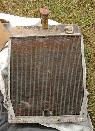

Rich, here's a pic of one.

Man those rads are works of art. I love just looking at the curves and lines

Posts: 2,984
Andrew
Precisely whys rad shop told me to go away and never come back!
There is a ton of work to rebuild one of these.

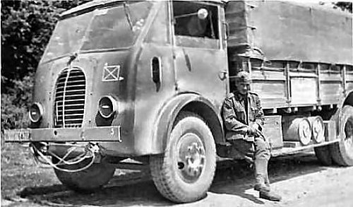

Hi Lynn, what about this one? Could be correct for the Mk.III?

Petr, I have no idea! Never seen that type before. Does it carry a part number on that plate on the l/h side?

Old 07-05-14, 16:09
Join Date: Mar 2014
Location: Czech Republic
Posts: 549
Lynn, there is "FORD GEFA 8242?" on the brass rectangular plate on front top right corner.
On the back side there is a copper slider bar (upside down) marked "Chausson Garantie No. 1773306".
Chausson is a french automotive company, right?
So, another mystery part on my carrier
Judging by the filler neck I'd say Matford truck, perhaps brought to Czechoslovakia by the Wehrmacht. Someone may want this radiator so it would be worth putting on ebay.
http://www.german.o5m6.de/matford.html

For the northern guys in cooler climates, Rob's photo shows the tropical core (as Chris V. said, "four and a half") I think these cores are also used in CMP Ford trucks? While I'm being unsure, I think the trucks have the bottom spigots exiting from the bottom of the bottom tank.
Another possibility would be post-war Simca truck, which probably retained the angled filler neck. Simca took over Matford after the war and continued producing flatheads until the '60s, for the Vedette and for their trucks.

Yes, could be quite possibly Matford truck! Thanks for this!
