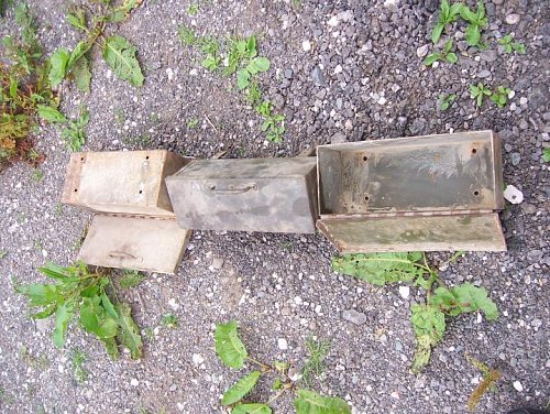

i'm hoping some of you guys might be able to help me identify these parts, I'm pretty sure this first one is carrier, but where does it go? It has the part number C01UC105433 listed in the parts book as a ammo box but not shown on the drawing.

The bin looks like the radio spare parts bin that sits next to the ammo bin by the radio operator... It would be the first bin nearest to the centre bulkhead on the drivers side. I cannot gauge it's size by the pic, if it is that bin, I would be interested in one of them should you sell.

The boxes are about 8" square and about 10" high. I was thinking it's the box next to the passenger seat, but it's not labeled up on the drawing.

Hi John Richard has it right, about the bin. The other bits are not carrier though, unless they are from a later model.

Are they the larger ammunition bins, TL 13065? Your estimate of 8x10 inch suggests they are. John, what is the part number punched into the side? The retaining clips are missing from the engine facing side. The clips held the spares wallet for the BREN. See Jordan B., who recently installed one. There should be a packing board between the bin and the mudguard. That will explain the rather longish 1/4 inch flat head countersunk retaining screws. The images from Steve Tegner in J'burg, RSA show the spacer in place on the museum MK-I*.
If it is the (much) smaller bin, as Richie and Lynn say to hold the radio spare tubes box, it should also have the clips on the front to hold the radio spares fuze box. A search of the assembly number in the parts manual will reveal the bin number. I will post an image or two. Bruce P likely has images of both with the spares cases in place.

Thanks for all your help. Micheal i think you have the correct one with the ammo box behind the driver there is the remains of the clips on the box. The exact measurements of the box is 8 1/2" x 10 1/2" x 11".
Would someone be good enough to do me a drawing of the clips that should be on the box?

The big bog is an anmmo box for O(two?) 3.7" shells. Many Loyds had them on the front. they are fairly common. The others are new to me.

Default The boxes loo.k like LP boxes
In the attached pic the two tall boxes are about 8" square and 10" high.
They hold Iron rations and Cooking Utensils in an LP carrier.
If you look at the bits in a Tamiya 1/35 Mk II carrier model, there are a a set of them in the back left corner of the hull in the instructions.
(The Verlinden 1/15 model doesn't have them).
Just for those who don't know LP carriers:
The squat box holds the cooker which is a Coleman type in a cylindrical tin.
The open frame in front holds a wooden ammo box for 1248 rounds of boxed 0.303 and the clips at the back hold 4 Vickers ammo boxes on end. (not bags as Nigel calls them)
The big ammo box is 1200 long and carried two rounds of 3.7" AA as Lynn says. They are virtually the same size as the carrier kit box, and I have seen pics of them used across the front of Kiwi carriers in Italy.
Post war many Kiwi LP2A were converted to Support weapons roles, and the five big bins at the back were replaced by a 3.7" AA box on the shelf.
