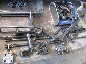

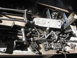

As you may remember from my Lynx restoration thread, I used molasses a heck of a lot to clean almost every small part. I use a 10 to 1 mix and find that it does work faster in the warmer months.
Name:	Lynda Griffith082013 025.jpg
Some of the many small bits that make up a Lynx after they have been in the solution and wire brushed after being pressure washed.
