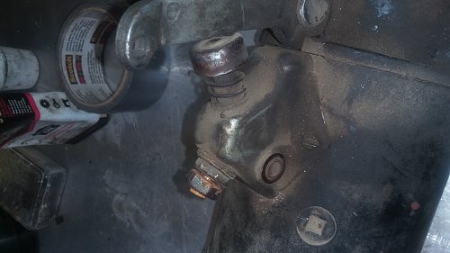

I need a new mechanical starter switch for a Mk II Canadian Carrier. The switch is shown in the first pic below. Anyone have a part number?

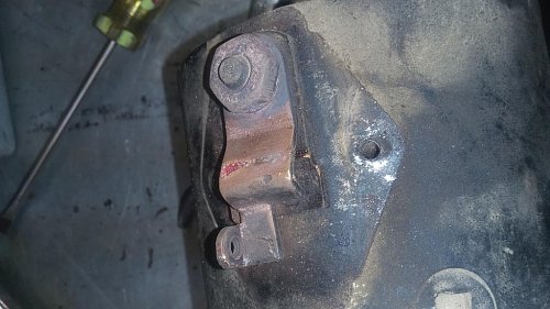

Does a new switch come with the insulating plate and copper contact bar that are bolted to the casing, as shown in the second pic?
Also, has anyone wired from the small lug shown in the second pic to the coil negative terminal to bypass the ballast resistor while cranking?

Isn't it the same switch as a 1940s chevrolet? http://www.ebay.com/itm/Ignition-Sta...dVn-0V&vxp=mtr
Alternate/OEM Part Number(s): 1858200, 277628, 820052, DR464 , 1S5216
As for the bypass, I think you would need to put a diode in the bypass wire so the starter motor doesn't try to draw current from the distributor.

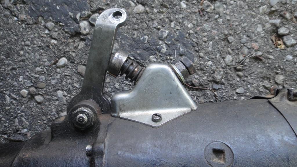

Similar but not exactly the same. The sheet metal cover on the Carrier switch has a kick-out at the push-button end that looks like it is needed to cover the nut and stud on the casing shown above.

Ah, I see that now. Perhaps you could gut the chevy switch (or any of the many similar switches used on tractors) and move new contacts into the original switch.
Doesn't have to be a diode for the wire of course. You could go old school and use a relay. But there are diodes small enough that you can almost hide them within the sheathing for the wire.
Personally, I use a 12 volt battery on my starter, and the 6 system merely runs the distributor, a solenoid, gauges and lights. Incredible starting without the load of the starter on the system.

Malcolm, these were common back in the day. What about cleaning yours up?
Don't sand it, file it. I'd guess the other contacts are not badly burned. You could judiciously re shape the one we've seen if there is not enough travel?
Rob,
It's not the contacts that are the problem, they're in reasonable shape, it's the insulating sheet and washers that are falling apart.

Had a quick look at the mk2 manual and sure enough, no part number for the complete switch.......just 20 numbers for each and every piece in the switch. There was a head number, but it reads switch housing or something like that. Hard to say if it's for the whole switch or just the housing.
Pretty sure the chev switch will give you the insulating washers and contacts you will need to freshen up the original.
