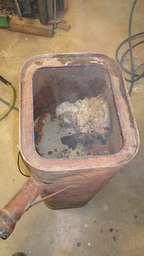

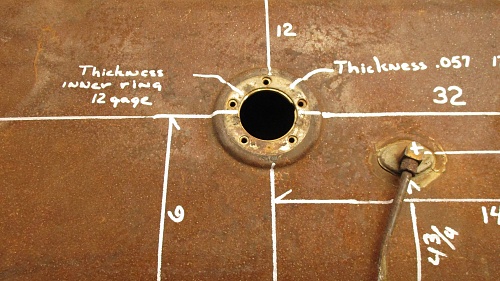

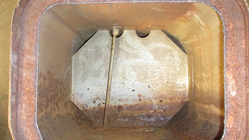

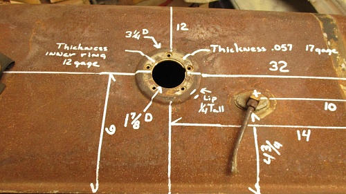

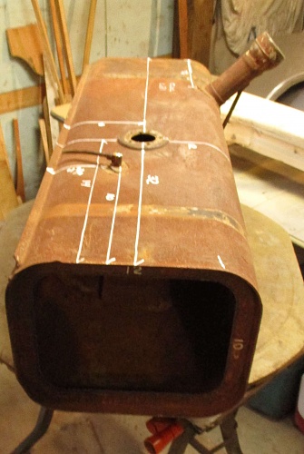

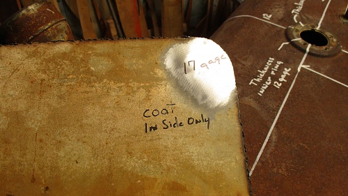

Hi All
Here are photos of outside and inside of one of the gas tanks off my 1941 Pattern 12 C60L. I'm posting these in response to a question by Jacques Reed in his tread concerning removing a dent from his tank.
http://www.mapleleafup.net/forums/sh...835#post245835
Posting this as a separate thread so the MLU search engine can find it by topic head easier.
My tank had been open to the elements for many years before I got the truck and had visible nesting material in the tank no smell of fuel and rust holes. Hence my decision to open the tank up to see how it was built. The cutting was done with a plasma torch the only smoke or fire was from the nesting material catching fire and smoldering. The measurements are those I felt necessary to reproduce the tank. If you don't see a measurement that you need just ask.

Default Fuel Tank C60L Measurments
Continued-
I have these as higher resolution photos if you need them just let me know which photos and I'll e-mail them to you.

Default Fuel Tank C60L Measurments more photos
Not knowing how to work around the limit on photos here is the third installment
If you are look for a source for the filler neck, the through side of the cab filler neck on 1948 vintage Ford F Series trucks with the behind the seat gas tank are a very close match.
Hope these photos are of help
