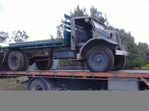

Good day
This is the truck I bought in February 2015. It was supposed to have been bought by the previous owners in 1946 from a nearby aerodrome Cecil Plains, I think the AWM records will probably show who actually bought it.
Name:	Wild F60L  Truck leaving it's home of the last 70 years.jpg
Name:	Wild F60L loading  17-02-2015.jpg
It is serial # 14717 Engine # 2G40613F ARN 46660
Cheers Ken

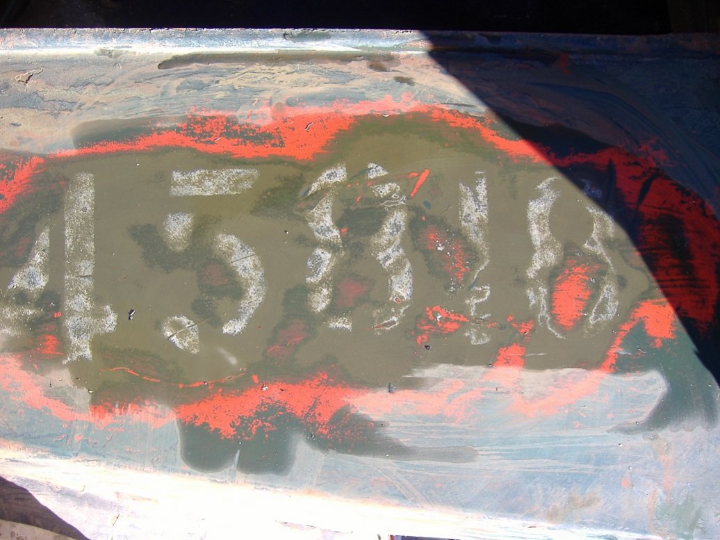

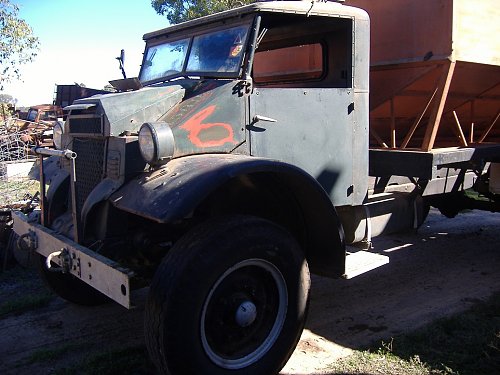

Default F60L ARN 45818 cab 12
Good day
This is the F60L I bought last month, and while it isn't mint it has got that minty feel about it. I haven't got much history on it even though it has been in the one family for at least 65 years.
It doesn't have any data plate on it but thanks to Keith in one of his posts, I was able to find the chassis # on the RH side of the chassis. It has had a factory replacement engine and transmission fitted at some stage as the transmission doesn't have the engine # stamped in it.
Name:	Chard F60L Front of cab.jpg
Name:	Chard F60L LH side of cab.jpg
Name:	Chard F60L ARN 45818 (best photo) (2).jpg
Name:	Chard F60L radiator overflow tank.JPG
Chassis # is 2G40452F ARN 45818
Cheers Ken

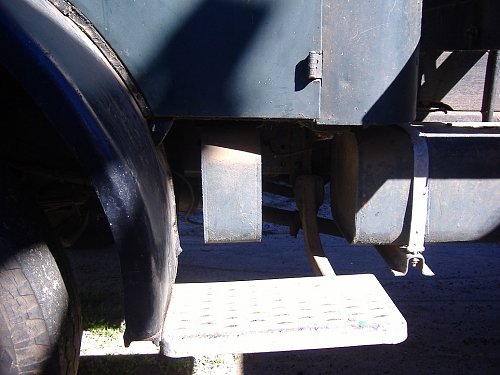

Old 02-08-16, 15:37
Beau Bruce Beau Bruce is offline
Join Date: Jul 2016
Location: Young, New South Wales, Australia
Posts: 33
G'day mate,
What's the little tank under the left hand door for do you know.? My cab 12 f60l only has one main fuel tank on the right hand side and that little tank under the left hand door (Whether the left hand main tank has previously been taken off I'm unsure), i was thinking that it might of been a starting tank then switched over to the main for when running on low octane fules, just like the old John Deere tractors and such do. Thanks
1943 Chevrolet C60L Ex RAAF crash tender Cab 13 (On the road but forever under restoration)
Just a young kid in an old guys game
Old 03-08-16, 02:41
Join Date: Apr 2008
Location: Qld Australia
Posts: 238
Good day Beau,
The little tank is the radiator overflow tank. It is usually missing off most trucks, as they get damaged or rust out.
You are very lucky to still have yours, I didn't notice mine until I took the photos as I didn't expect it to be still on the truck.
Cheers Ken

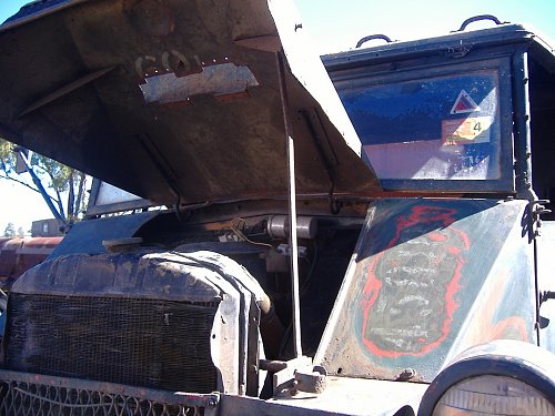

One of the first things I have to do is repair the mods to the bonnet. Somebody cut the front of the bonnet and bent it up, they also put a very well made hinged flap in the top of the bonnet, all this work to direct more air in to the radiator and engine bay.
Name:	Chard F60L 60l shown under bonnet.JPG
Name:	Chard F60L mods to bonnet.JPG
The top flap is seized open at the moment.
I was just thinking the top flap would help stop vaporising too. A lot of the AWM pictures show the North South road cab 12s with the bonnets off.
Cheers Ken

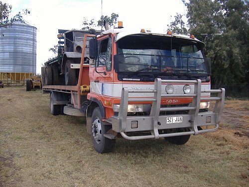

So now I am assuming that the truck came up to Qld with at least the front part of the portee frame still fitted, with maybe the RAAF body bolted on in place of the 2 pounder frame. They had quite a few kids and they would only have been little then, I think it would have been a job to get them to sit safely on the portee seat for that distance.
Why why why didn't I ask what was on the truck for the trip up, I did ask about the cab roof that's how I found out about child care in the late 40s.
The previous owner was ex RAAF having trained pilots on Oxfords and Ansons.
We drove the truck from the farm to my place and have had it in a couple of parades as well. It is stinking hot in a parade without a roof and I usually keep the doors on half open latch to let a little bit of cool air in.
Ken

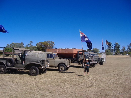

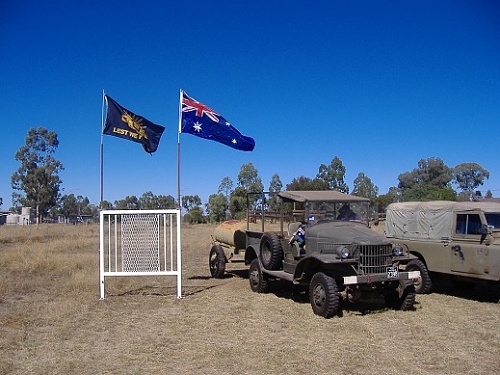

Good day,
Every year I put on a bit of a display in the front yard of the farm, nothing much, usually whatever will start on the day. This years line up included Albert the Ford C60L ARN 45818, Series 2a Landrover Binned + workshop trailer, Series 3 Landrover GS + 1/2 ton trailer, and my trusty Dodge WC21 + water trailer.
This year one of my grandsons had a sleep over so that he could help me put the trucks out, I like to have everything out by 7.30 am so that I can get cleaned up and go into town for the march. I had 3 grandsons in their school uniforms in this years march.
KenClick image for larger version

What a wonderful display of vehicles and of national pride, thank you for sharing
