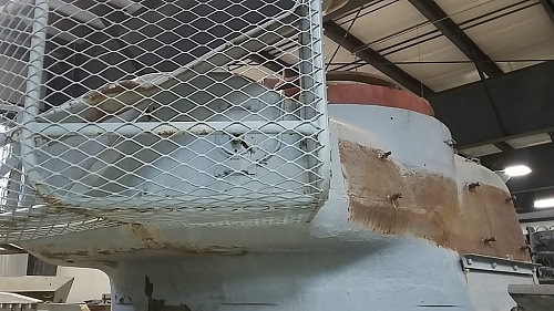

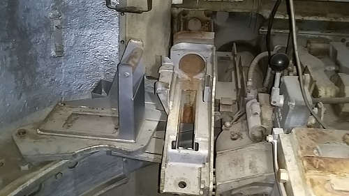

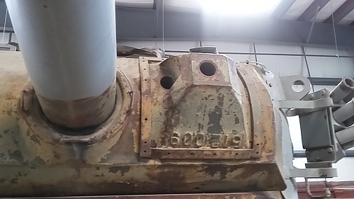

Hi, I'm a volunteer "fixer" at the Ontario Regiment Museum in Oshawa, Ontario. We have a project to get one of our Canadian Cent's up and running this year. Not pristine, but running. We just bought a nice Mk 4b engine for it.
I'm a newbie at this so I have been trying to figure out what Mk of Cent we have. It has the armoured fuel tank on the back, a 20 lbr gun, but it it doesn't appear to have the voltage regulator box in the hull for the engine-mounted generator. I have searched on what the various Mks are but it's confusing. Can anybody help me with what we have here?
Malcolm

Old 21-07-18, 02:03
Malcolm Towrie Malcolm Towrie is offline
Location: Whitby, Ontario, Canada
Posts: 306
Mike,
I can see no evidence of a layer of armour welded over the original upper glacis plate.
I have attached photos of the co-ax mount and the rear of the turret. Hopefully, those will answer your other two questions.
Malcolm

I'm a bit puzzled by your images, as the interior shot appears to show a .50 RG and .30 Co-ax combination MG mount, which would indicate the main armament would be a 105mm, rather than a 20-pdr. Do you have any images of the front of the turret and main armament, please? The turret is also fitted with a rear basket to hold the searchlight normally fitted along with the Infra-Red equipment.
A Centurion:
(1) with 20-pdr, without up-armouring, and fitted with a long range rear fuel tank, and a co-ax of a .30 cal, would be Mk.5 LR.
(2) with 105mm, and as above, would be a Mk.5/2 LR
(3) with 105mm, , fitted with 50 RG, , IR sights and searchlight and as above, would be a Mk11 LR
I'm not aware that Canada ever fitted the .50 RG to tanks equipped with the 20-pdr main armament - as far as I know, Australia was the only Centurion operator with that particular combination.

An old hand told me today the Cent came from St. Hubert Base in Quebec. We got it when the base was closed down. I see from Wikipedia St. Hubert was primarily an air force base, so this surprises me a bit. It was closed down in the mid 90's. I've only been at the museum for a few years but I'll go out on a limb and say that not much if any paperwork exists or changes hands when an old beater gate-guard is given to a museum willing to take it. But I will ask about paperwork, just in case.
A guy who worked on the tank a few years ago showed up today so I picked his brains. He showed me the two large tapped holed in the top of the mantlet where a mount for the spotlight was attached. He confirmed what Mike said about the part of the bustle designed for storing the light.
He also told me he believed the CFR number painted on the tank, 52-S-100S (see photo) is a typo and should be 52-8-1008 (or was it 52-81008?).
He confirmed the upper glacis plate doesn't have the additional welded armour. There are no brass plates inside the tank. He showed me 4 tapped holes in the left hand wall of the driver's compartment where a plate used to be.
He confirmed there were 2 coax machine guns installed but he was surprised to hear this indicated a later Mk as he thought it was a Mk 5/2. His theory on the 20 pdr is that it was installed when the 105 was removed for use elsewhere.
He showed me where a 50 cal was mounted on the commanders cupola.
There is a small control panel in the turret that refers to IR lighting.
He also suggested that the impecunious Canadian army was selective on what upgrades were installed, based on need and cost, so some cherry picking was done. Maybe that explains an unusual mix of upgrades?
I have attached some photos of the front of the turret as Mike requested.
Thank you for your help on this. It's a fascinating exercise.
I'd be happy to take more photos if it would help.
Malcolm

That looks like a 105mm gun profile to me, but I'd have to see more of it to confirm, especially the fume extractor. Mind you, it is possible to jamb either a 20 pdr barrel or a 105mm barrel into the same breech and mounting.
I'm betting it's a "Tank, Medium Gun, Centurion Mk 11 LR".
The tank would be fitted with two co-ax weapons, but one is the Ranging Gun, the L6A1, .50-cal, which is restricted to firing 3-round bursts at each depression of the firing pedal (actually, to be precise, three single rounds, controlled by a controller box). So the .50 is not strictly used as a co-ax machine gun, hence the name 'ranging gun'. It was originally termed a Ranging Machine Gun, but the terminology was altered to reflect its true application as a ranging gun only.
However, the controller could be overridden by the loader/operator by hand, in which case the weapon reverted to true automatic operation.

Sorry, Mike, I didn't realize you wanted to confirm that the gun was a 20 pdr. I can tell you it has no fume extractor at all. Does that confirm it is a 20 pdr? If not, I'll take more photos.
Malcolm
Old 22-07-18, 07:46
Posts: 2,390
Probably, Malcolm - the early-issue 'A' Barrel of the 20-pdr had not fume extractor, whereas both the 'B' barrel and the 105 mm did have a fume extractor fitted (but with different 'looks': the 20pdr had round ededges and concentric to the barrel, the 105 had squared edges and was eccentric).
I suspect, though, that what we are seeing is a Mk11 LR with a 20-pdr barrel fitted. Maybe the museum could locate an L7 105-mm barrel and do a swap?
52-81008 was in the series of numbers for the Centurian tanks. I believe they started at 81000 and went up from there. The ARVs were in the same block. It is just as possible the last digit is a 5 on yours. It would seem that deterioration or a quick paint job in it's past lost the original numbers.
