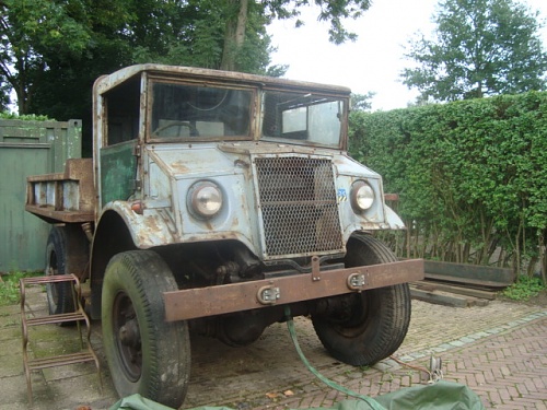

Hi help needed I have brought a CMP what I believe to be a Artillery gun tractor please see photos any info would be good I think it was a beetle back originally but the back has been chopped off and a GMC back put on it has the winch and the engine not sure if it runs, I would like to restore it back to a gun tractor. The only ID is the chassis no which looks like J844N2685
Any info or plans for Fabricating the back please

Default Chevrolet CGT FAT
Hi Richard,
Good to see this one resurfacing. Last time I saw this, it was for sale in the Netherlands.
Name:	Chevrolet CMP FAT Quad WW2 img_1.jpg
This was once a field artillery tractor (FAT) indeed. Most survivors have the rear body missing. Chances are slim to find a rebuildable body, as most were scrapped after they were removed to make room for a more useful load body or a crane. They can be reconstructed, as far as I know there are no plans available. One restorer in Belgium used a 1:35 scale model for dimensions, others have used a restored FAT to reconstruct the body. Roger Wilson in New Zealand builds sheet metal kits for these.
Another option is to build an Indian Pattern FAT with a wooden body. Much easier to do and much rarer!
