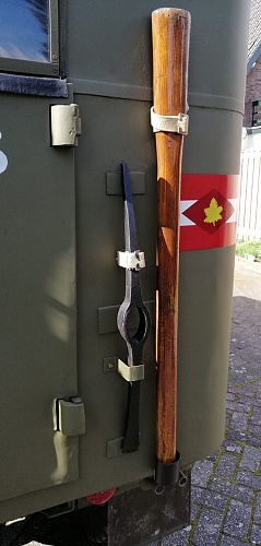

Who knows the dimensions of the pick head and its helve, as used on CMPs?
Size:  56.8 KB Click image for larger version

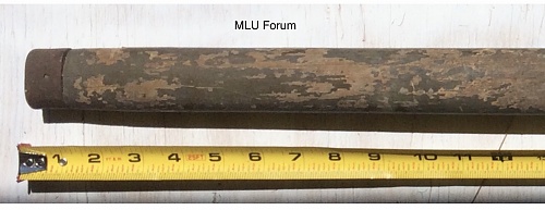

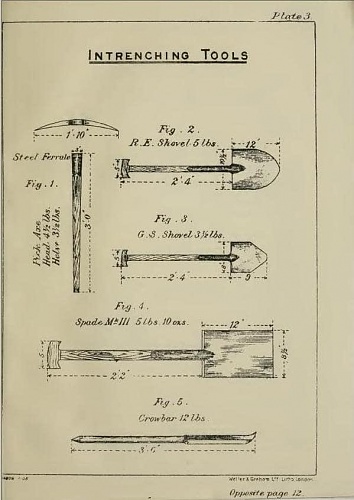

Hello Hanno
Mine are 22 3/4 for the pickaxe head and 3 ft for the Helve. These are DND issued and dated 1941. I am sure they are the same size as the ones on the vehicles.
Eric

Old 26-07-20, 22:38
Posts: 14,946
Hello Eric,
Thnaks for posting the dimensions.
Arie Hamer measured up the one on his HUP and confirmed the head is 58 cm. long. Good to know the helve is 91.5 cm.

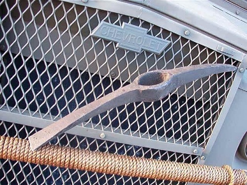

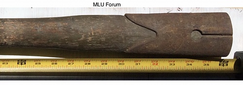

Hanno, the two shown in your two photos are (obviously) different. The first is an American type, while the second is British (as found on carriers). The American pick heads come in different lengths (not sure about military ones), and I wonder if that is why the one on the back of the CMP is not sitting its end against the rub plate.
Interestingly I have a pick mount that takes (what I assume to be?) an American pick, but has a BSF thread on the stud.
The shorter (lower) one is from a Canadian U.C.
The longer (higher) one , I'd like to know its original application?
The Australian carrier used the American pick, but used Unified thread forms (plus BA for small stuff) So, i don't think its from there.
Btw, with the British helves, the early ones had a steel ring at the hand end (WWI) the later ones were plain. These were used through WWI and WWII.

Old 27-07-20, 04:58
Further: I've had a minor epiphany. I believe this was made to fit the carrier as well (same mounting) Maybe it was to do with supply of picks? I will be watching for carrier pictures with the U.S style pick from now on.
I had assumed that this was from An Australian pattern carrier, until I checked the thread of the stud.

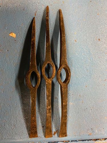

Old 27-07-20, 08:20
Posts: 14,946

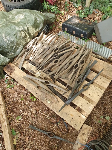

Pickaxes from a Czech collector. Obviously, they are not all the exact same length. Due to (hand) forging by different manufacturers, or because they had a different application? Length is 55, 59 and 60 cm.
Radek checked and all three fit the bracket on his Austin truck.
ID:	115211 Click image for larger version

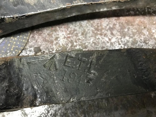

Old 27-07-20, 12:03
Yes Hanno. The British style has a steel wrap that the pick head sits on. The handles you show would be U.S style.
There is a British miners pick in the same style, but it is substantially smaller. It is about half way between the Vehicle one and the infantry one that has the webb cover and the mine thingy on some handles. I'm not very knowledgeable on them either.

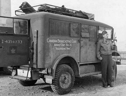

I have found that pretty much any Canadian made vehicle that has a brackets for the pick axe, used the British pattern of pick axe head and handle. I had not noticed before that the pick axe in the photo of the cmp tool layout is a US pattern version.
A surplus store in Calgary Alberta had hundreds of the WW2 Cdn pick axe heads and dozens of the handles, all to the British pattern.
In the 1950s, the Canadian military went to the M-series vehicles (aside from the Centurion, the Ferret, and the Triumph Motorcycle) and the US pattern pick became the norm. When I was still in the service, you would get the odd WW2 Cdn pick axe head mixed in with the US ones when ordered from supply.

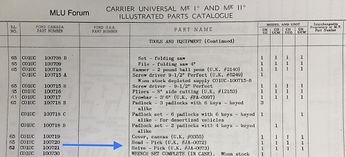

Posts: 3,682
Would the British Master Reference Manual list detailed specifications for JA 0072 and JA 0073?

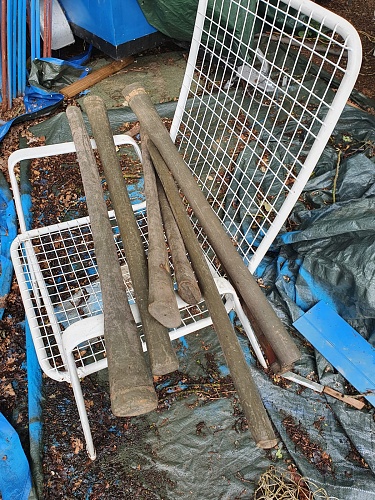

Seeing all the info on pickaxes, I wonder if anyone can identify this helve variation.
It seems a standard British pattern metal ferule at the bottom, stamped No 2.
The wooden helve has "51" in red paint.
The odd bit is the metal cap at the top of the helve, it is too wide for any British pattern pickaxe head to fit over it.
Attachment 115232
Attachment 115233
Attachment 115234

If you can't put the pick head over it, then it has been re- purposed, as some kind of rammer? Interesting.

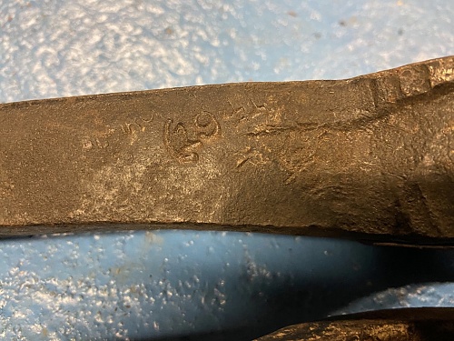

B. Harris B. Harris is offline
Join Date: Jun 2005
Location: Ontario Canada
Posts: 419
Default Canadian Pick Axe Head
For Further Deliberation:
The Canadian heads (Pickaxe), the only one I have seen has been manufactured by Welland Vane Ltd.
They were located in St. Catharines, Ontario, Canada.
Markings are typical..... W.V. and the date.
Also is 4 1/2 which is the weight of the head.
They will fit MKII and T16 Carrier mounting head, confirmed. Unsure of MKI fitment.
I have a head for sale on the exchange threads.
Harris

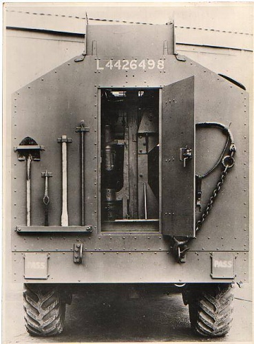

Here is a photo of an AEC armoured demolition vehicle, showing the pioneer tools (is that the British terminology?) neatly stowed on the rear:
shovel, pick, helve (note that it doesn not have steel bands!) and crowbar.
The vehicle in the photo is from contract T9291 covering Lorry 3ton Armd Personnel and Armd Demolition, 100 vehicles between the two types.

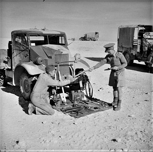

Also note that there are multiple pictures of tool layouts (Clives CD has 3), one for each type of CMP so it seems.....but I guess they were all done in one picture session, as most tools are the very same ones, while only some items differ.

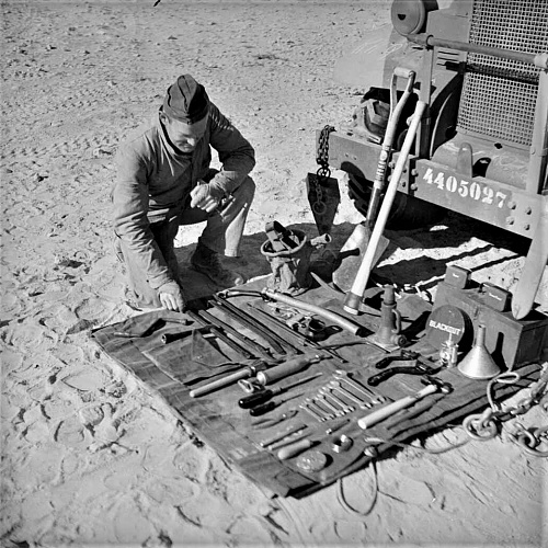

New Zealand transport kit inspection, Egypt, 1941.
"US" pick?
ID:	115447 Click image for larger version

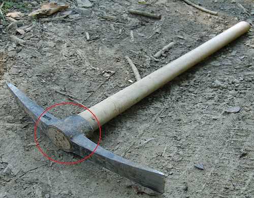

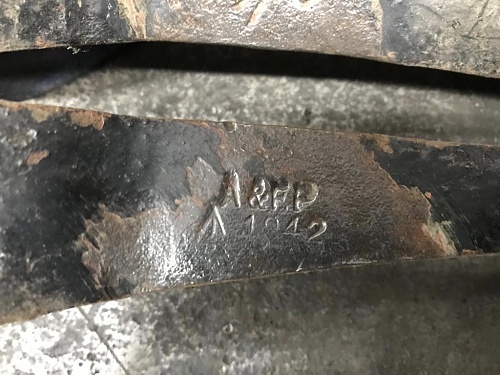

I have always differentiated the British pick from the US pick by the extra shank on the pick axe head for the US one, vs the no shank on the British one. As Lynn mentions, the British one has the metal reinforced handle at the head, and a ring on the bottom. The US handle is all wood and larger diameter.
Hanno, The (later)WWII handle did not have the band at the grip end. The pick head end will have the steel sleeve, to go with the head shown. (at least, I've never seen one that didn't) The logic is that the long hole in the American one stabilizes the handle in the head, whereas the smaller and shorter hole requires the steel sleeve to stabilize the head on the handle.
I've been wondering about the what you meant with the "extra shank on the US one vs. the no shank on the British one". Remember I am not a native English speaker.
Doing a picture search combined with Lynn's remark about the "long hole" I think I now have a grip on what the US pick looks like.
Note: the Oxford Dictionary of English states that both "pick" and "pickaxe" have the same meaning, that being a tool with a long handle at right angles to a curved iron or steel bar with a point at one end and a chisel or point at the other, used for breaking up hard ground or rock.

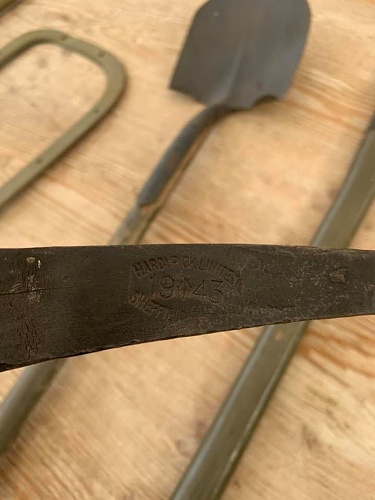

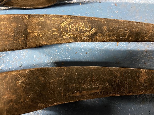

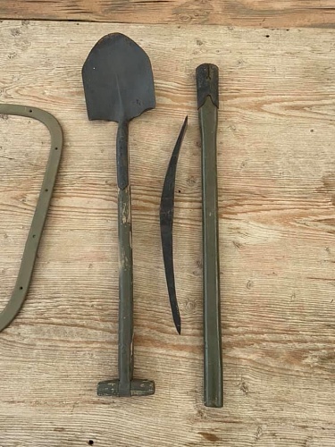

Posts: 14,946
Good picture of a British pick and helve made in 1943 by Hardypick Limited, Sheffield (part of the kit of a Daimler Dingo in the USA).
It clearly shows the shank is about half as high (deep) as on the US one, therefore the British helve has a metal reinforcement for stability of the pick head.
Thus far, I have only seen the US type fitted on / supplied with CMP trucks.

Old 20-08-20, 14:40
What do period British civilian picks look like? Do they also have the narrow shank and metal reinforced helve? Or is that unique to army picks?
Old 20-08-20, 14:57
Posts: 14,946
See David's earlier reply:
In my experience all civilian British picks look exactly like the one in the above post #25. It is only British military picks that have the metal reinforcement at the business end of the handle. I have always assumed that this was because they were stowed separated and repeatedly separating the civilian type would cause wear to the wood. The Americans presumably just went with standard civilian tools. As usual Canada got caught in the middle !
Old 31-08-20, 00:10
Posts: 7,624
I was looking at a copy of the "factory photos" CD that Clive Law sent me, and ran across the photo with the tool layout. With the excellent resolution of the photos, I was able to enlarge the photo to come up with the manufacturer's name "hercules". The same logo can be seen on the HUP photo Alex posted with the pick axe handle stowed.
I did find some Hercules tools listed on the net, but they seem to have migrated over to fiberglass handles now. I guess the challenge to the true CMP nuts will be to find vintage Hercules handles to stow on their vehicles.
When I enlarge the photo of the tool layout, you can also read the nomenclature on the shovel. It is not the manufacturer but rather a label for GM's stock room.
