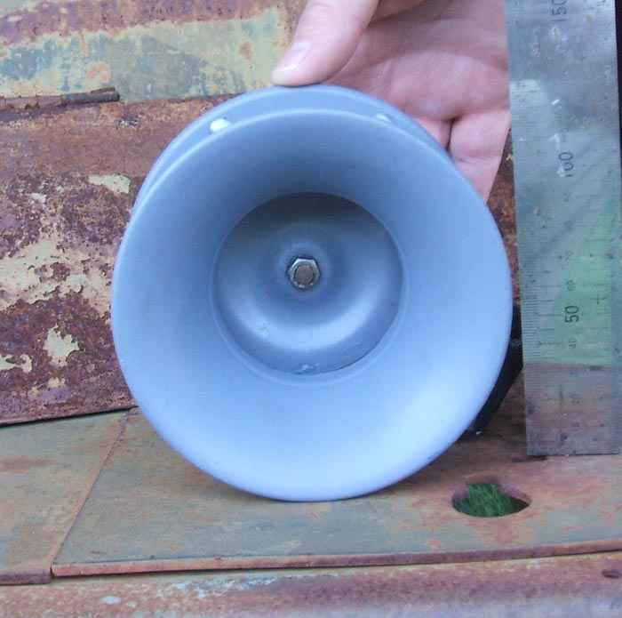

Default What you are looking for
Here are two pictures. one is a short horn, the other is a long horn. If something leaks out, stay out of the way!!!
