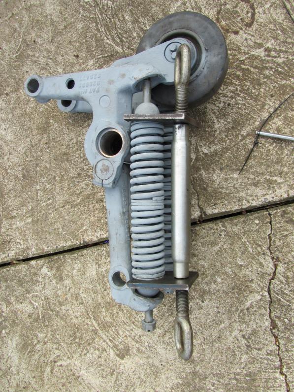

Hey kevin, nice press but not sure its as easy or safe as the correct tool which I made in about 30 mins with some theaded bar, some tube, a welder and some nuts. Plus it goes in the tool box

Andrew that is the same style tube they use on Mini's to compress the springs.. bit of tube with a flange on then a threaded bar inserted down the middle and a couple of nuts on the end.... excelent bit of kit.... only worry is if the threads in the unit on the vehicle are rotted or damaged... great stuff

I missed that tool completly, is featured in carrier workshop manuals?. I will set to making one of those before doing my rear springs, interesting you only have one set of springs were a universal carrier has an inner set.

Hi Kevin. I am not going to be able to take the credit for this, but it was pointed out to me by first of Sean in Florida, thanks, and then Lynn found the original drawing. I have just lent mine today, by coincidence to Ben. It worked a treat for me, and I have to say I am rather proud of my little tool. It was just really easy to work and did the job superbly. As mentioned by Richard, if you have problems with the threads I guess it not a great option though.
sorry forgot to reply to the question about inner springs. The T16 has inner springs on the rear bogies, not the front. I guess this is to stop it rearing up and counter the weight of the engine, box and axle. The photos posted were front units obviously.
