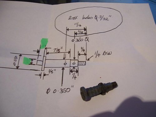

Hello,
Can anyone help me with the missing dimensions on my drawing. I'm making some of the locking plungers for the shutters. I have an original to copy, but the end that goes into the holes to lock the shutters has suffered some corrosion and is difficult to get a true dimension. Would someone be able to tell me the lenght and diameter as shown below.
Thanks.

I have 3 NOS pins and the plunger measures as
overall length 42.50 mm, 1.6735", 1 43/64
pin length 3.48 mm, .137 , 9/64
pin width 4.85 mm .192 , 25/128
Do you have a drawing for the pin housing?

Hello Roberta,
Thank you very much, it's just those dimensiond i need, i have an original brass housing to copy.
Best wishes

Hello Roberta,
Could you check me a couple more dimensions please. Can you tell me the lenght and diameter of the pin that goes through the plunger pin. And if you have the spring could you give me the lenght and diameter of spring.
thanks
John
