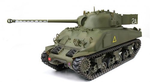

I'm a model builder and will soon start on a new 1/6th scale kit of Sherman Mk.Ic "Firefly" Hybrid:
http://www.dragonmodelsusa.com/dmlus...l_DRA75048.jpg
I want to build this one up as a Canadian version and I have a few questions. Hopefully some knowledgeable members on this forum will be able to answer them for me:
1. Which Canadian units supplied with this type of Firefly took part in liberating Holland?
2. Did Canadian Fireflies carry an anti-aircraft .50 MG on a pedastal mount on the turret roof (or any other MG)? I've browsed the web for pictures of Fireflies but were unable to locate any pictures of MG's mounted on the turrets of Fireslies. I wonder of the AA-mg's were 'sacreficed' to allow more internal storage for ammunition for the 17pdr?
3. What unit and/or identification markings were used on Canadian AFVs?
I welcome any links to on-line resources that will provide more information on Canadian forces involvement with the liberation of Holland.
Thank you very kindly in advance.

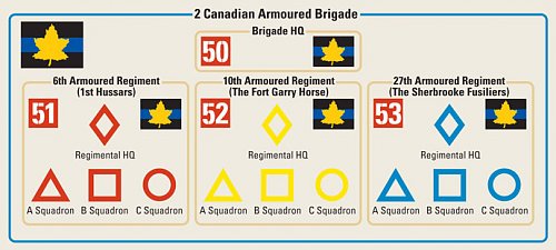

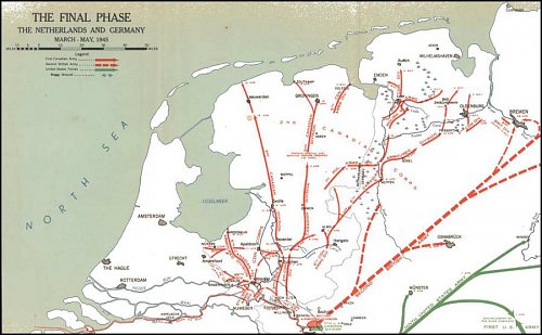

There should be two Fireflies per troop by this stage of the war.
The .50 cal as an AA mount, was usually not mounted on the turret top. Many considered it awkward, plus there really was no need since the allies had control of the skies.
It would take looking at individual regimental armour histories, but according to this map:
http://www.ibiblio.org/hyperwar/UN/C.../OpSumm-13.jpg
4th Canadian Armoured Brigade
21st Armoured Regiment (The Governor General's Foot Guards)
22nd Armoured Regiment (The Canadian Grenadier Guards)
28th Armoured Regiment (The British Columbia Regiment)
5th Canadian Armoured Brigade
2nd Armoured Regiment (Lord Strathcona's Horse (Royal Canadians))
5th Armoured Regiment (8th Princess Louise's (New Brunswick) Hussars)
9th Armoured Regiment (The British Columbia Dragoons)
I don't notice the two armoured brigades on the map, but since a regiment was already mentioned above:
1st Canadian Armoured Brigade
11th Armoured Regiment (The Ontario Regiment)
12th Armoured Regiment (Three Rivers Regiment)
14th Armoured Regiment (The Calgary Regiment)
2nd Canadian Armoured Brigade
6th Armoured Regiment (1st Hussars)
10th Armoured Regiment (The Fort Garry Horse)
27th Armoured Regiment (The Sherbrooke Fusiliers Regiment)
http://www.flamesofwar.com/Portals/0...g-Normandy.jpg
http://www.canadiansoldiers.com/vehi...ationsigns.htm
http://www.canadiansoldiers.com/vehi...edbrigades.htm
http://www.canadiansoldiers.com/vehi...ticalsigns.htm
