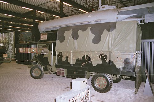

Correct, see two pics of the Ford F602L on display at the Overloon museum attached.

A very interesting set of pictures Hanno! If you look at the close up photo of the axle you will see the additional lower support arm of which I wrote. The axle that I still have does not have that additional support arm and it seems probale that in rough service it would not last very long.

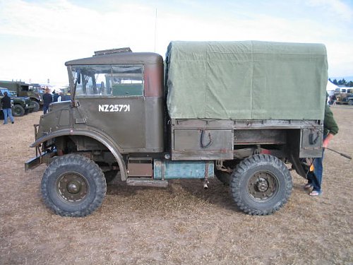

An apparent anomaly is the C8AX (NZ variant fitted with 16" wheels, making nominal load rating 15 cwt, and built on C15441 chassis) for which the expected designation would be C15AX. I'm inclined to suspect C8AX designation may be local misunderstanding, just like F60S designation seen on Australian F30 Ambulance.
I don't have a C8AX parts list to confirm this, but my understanding is that the C8AX is more or less the same set of parts as the C8A Heavy Utility series from the ground up to the top of the frame rails with a C15A cab and a (probably) unique cargo box. So, if the C8AX is actually a 15 cwt, wrongly named, does that make all Heavy Utilities 15 cwt as well since they are the same structural parts and drivertrain?

Grant, evidently there's another factor at work in C8A/F8A load ratings which differentiates them from C15A/F15A. Something to do with the car type rear chassis perhaps...? I really don't know enough about them to speculate.
