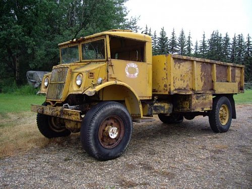

This Truck use to be in my yard 30 years ago .
Here are the numbers
Model# C 60448 M-GS-15
Chassis C-60448-M-W
CAB 15
Serial # 3844334574
Engine # PR 3975100
Order # PE -197-11
Date APR 24-44
Bob Hammond told me that it was in an order for Australia that was canceled because the war ended so it was sold to civilion use .That makes sence as there is no military signs on it .This is the original paint .The decal on the doors is the Alberta Motor Association The wheels are 1100x20 .The push gaurd,rearview mirrors, spare tire carrier, and what goes infront of the tool box are missing .It is almost rust free .Now being a Ford guy what went on the side of the cab by the headlight,the oilfilter?Does anyone have information about this truck?

If you could give us an enlargement it would help although it looks like some sort of civvy street mod as GM had repositioned the overflow tank to under the floor by that stage of production.
I've not seen that contract number down here but David H should be able to fill us in.

We have seen a number of "ODD" PE-197-12.....circa August 44-September 44. What set them apart is that they are ALL built with the 15cwt small axles.....even with helper springs the axles are the small ones and are usually equipped with 16 rims/tires in 10:50x16.......and this on a C60 L frame.
David had confirmed that this was a late Australian contracts.
This one from George is dated April 44 and is PE - 197 -11 and equipped with the full large C60 axle and large 20 inch rims........YET..... I have record of a similar (April 44 ) period C60L with the same PE - 197 - 11 contract with the small axles/rims.
Wonder if David can shed some light on the owner of that -11 contract....
Meanwhile....George.... that C60 of yours.....does it have a winch installed...?
That yellow paint could be its an airforce vehicle..... to bad you will have to get rid of it as you are addicted only to OD green .....
Bob C.

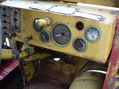

The picture on the side of the hood never had anything attached to it . It has the air compresser and had possibly a winch but it look's like it was removed as it has the drive for it . It was in a parade 25 years ago and had some red paint put on it but it is almost gone now. The original paint is very good and there is no signs of any military markings .I have the manual MB-CI that they were using but I should have a C2 .The only other Cheve thing I have is My F15A # 11 has has Cheve rear ends in it .Things don't rust here if they havn't been on the hiway salt The motor needs overhauling as it don't run .

Morning George. Take a look behind the passenger seat in your truck and see if the REL plate is still attached to cab wall. The data plate is for Research Enterprises Limited. These trucks were used to pull Radar trailers. The one we have still had RCAF Comox on the door when we got it.
Rob

Thank's for the tip Rob .I never saw this litle plate till you said where to look .
Name:	CMP 60 015.jpg
Then I got out my air craft paint remover and under the door decals is the Royal Air Force decals . So now we know the rest of the story . A little knowlage goes a long way . Where would one ever find the winch that goes on the truck ? Maybe I can make one out of a truck rearend .Would there be a manual for this winch ? George

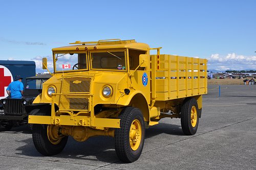

George. The winch is a very special piece of kit on the truck because of the way it mounts. Has two large flange bearing on each side.
These are pictures of the progress of our truck. These were taken on her first drive in about thirty years.
Still missing left fenders but it's getting there.
Rob

Thanks Cliff. I was just referring back to what George said, trying to make one out of a truck rear end. It's completely different the way it's mounted.
Rob

The tires on your truck look like the original tires that were put on by REL. Our truck had the same and all REL conversions had those tires
What's even better is if you look on the sidewall you may find the RCAF brand burnt into the sidewall like ours. We believe that our tires have been on our truck since new.
As for fenders, we now have everything to complete the truck including the other gas tank and dog house. I have a picture of the radar trailer and I'll post it later. Thanks to Barry Churcher for helping to find the short shaft from trans to transfer and the wheel cylinder that came from Holland.
Rob

George. What I'm about to tell you is unbelievable your truck and the museums trucks are sisters.
Your truck went through the conversion right in front of ours. Yours 52 ours 53. Can you imagine that, after all this time.
Here's the truck data plate for David's info.
Thanks Bob for the compliment, Coming from the CMP centre of the universe, it's great to get feedback from the Hammond barn folks. And yes we do have the box, and when we get back to work this fall, at the Skunk Works that will be the number one priority.
Rob
