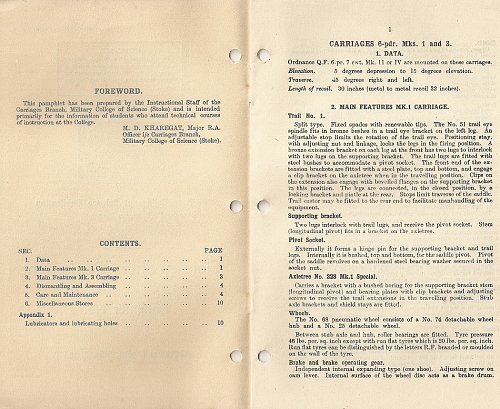

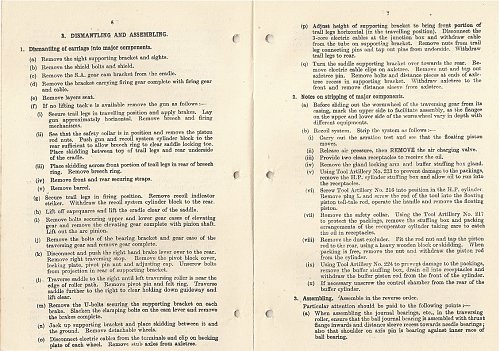

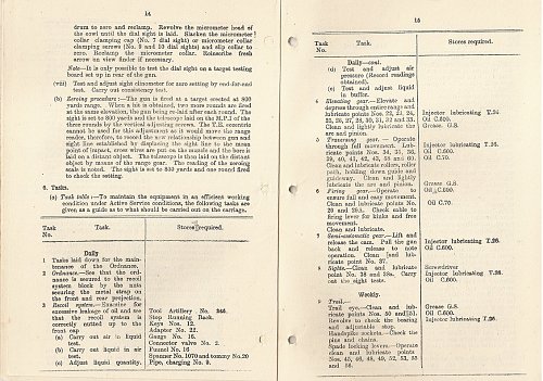

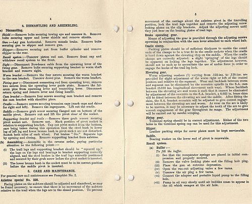

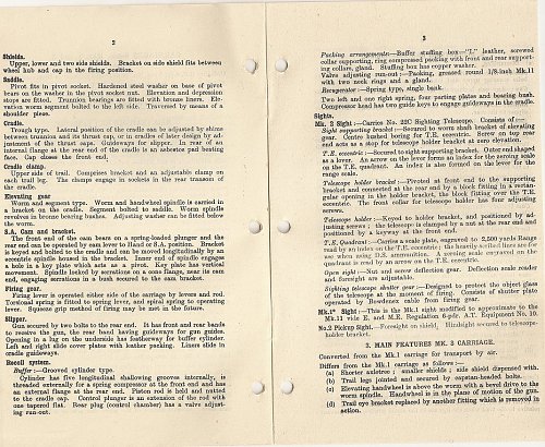

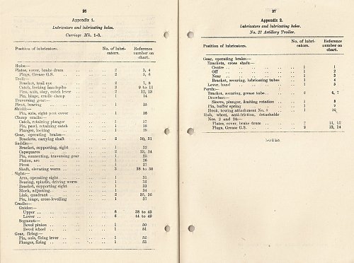

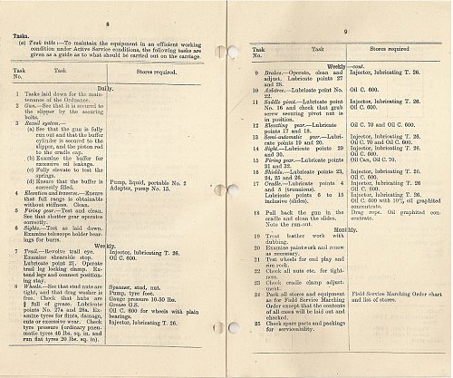

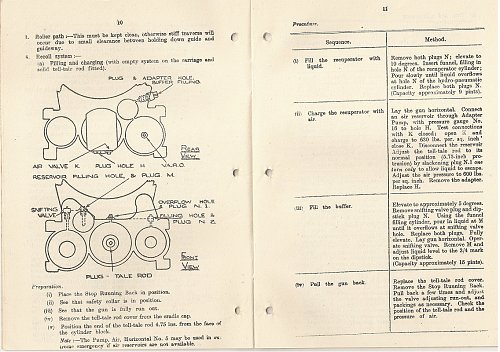

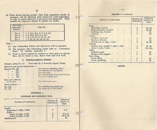

Default 6pdr Pamphlet
As there are so few pages... here for you all to enjoy...
Remainder to follow...

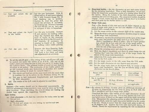

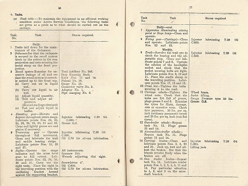

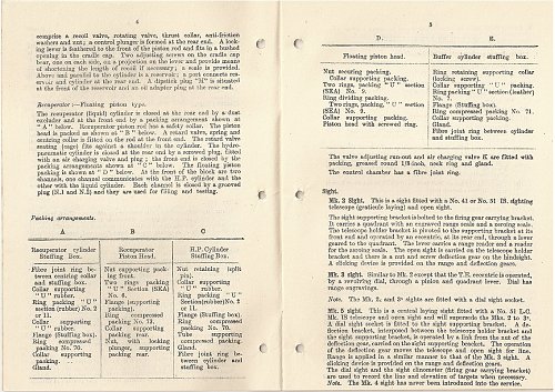

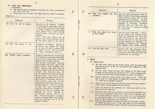

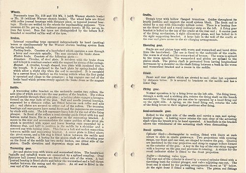

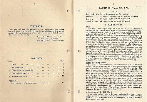

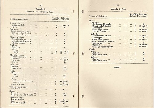

Default 17pdr - Pamphlet
17-Pdr Pamphlet
To follow...

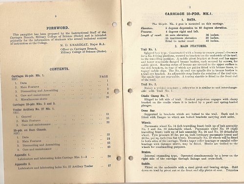

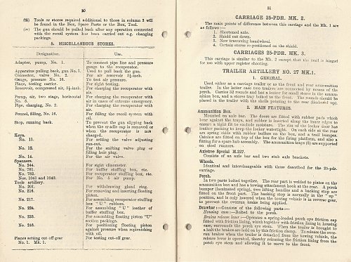

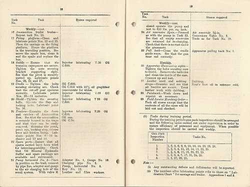

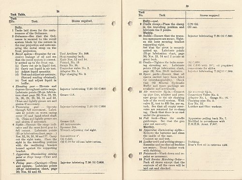

25pdr...
to follow...
