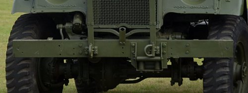

My cab 13 FGT is missing the cable rollers on the front bumper.
All the cab 13 FATs I have found on web do have the late, big one.
But the FGT in MB - F2 is a cab 13 but has the early, small one, used on cab 11 and 12 models. (So does the cab 13 C60L in MB-C2 book)
The thing is - the only roller set I have found for sale (yet) is the small one, so I am thinking about putting it there - but my FGT seems to have the later - round instrument -dash board. So maybe it should have the later type or the rollers, shouldn't it?
Thank you for your opinions,
Frankie

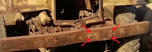

Here is a Picture of my bumper. It does not seem there are holes for the bigger type...? I am not sure how is it fixed there.
It's missing the scotch hooks, too, doesn't anybody have few pics of them?

Yours looks to have had the smaller type fitted, that uses the same holes as the D rings, though the bumper could have been switched at some point.

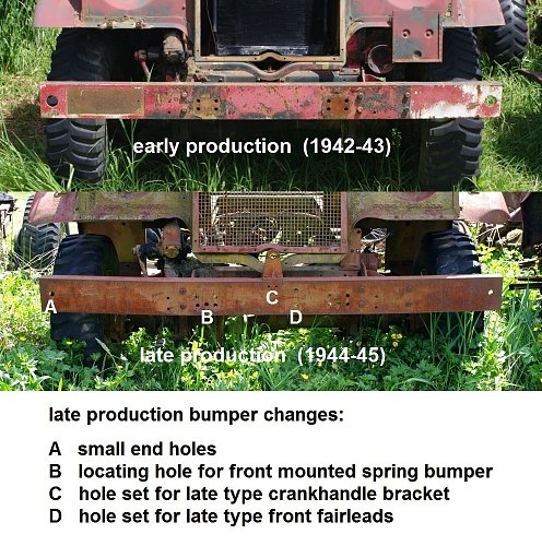

Relax Frankie!! Your vehicle is late production (ie. 1944-45) which includes certain features:
1. FORD CANADA front shell
2. Military dashboard (ie. round gauges)
3. Late type bumper (includes provision for late type front fairleads as shown below)
4. various cab improvements (eg. windscreen demister slots)
5. sling hubs front & rear
