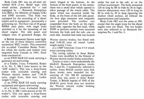

Default attached picture here for future reference
Hi Joe,
In his excellent study on FWD HAR trucks in "Wheels & Tracks" magazine No.5 Bart Vanderveen wrote this:
http://postimg.org/image/ilqzow771/
HTH
Cheers!
Last edited by Hanno Spoelstra; 24-09-16 at 22:17. Reason: attached picture instead of linked picture

Fantastic info, thanks!
