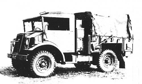

The body on your C15 looks like it could be the same as this one on this C15A 4x4 ? Were these the wooden GS bodies built before GMH began building the all steel GS body ?
I wish that guy standing near the door would move so we could see the tyre carrier !

Great find that C15, looks like a great project. The body is a rare Australian GS body No. 1, not many of those still around.
Rod Diery here on MLU has (had?) the remains of one of these body, can't think of another one.
If you restore it, please record measurements and construction details for others who may wish to recreate one of these.

Here's a picture of a C15 Cab 13 with the Australian GS body No. 1, courtesy of Dave Prince's Australian Army Body Types webpage.

Thanks everyone, the body is indeed the one illustrated (no1) I can see that the catch on the tailgate is the same as mine and the number of horizontal boards are the same.
I will cut the timber from local hardwood (Jarrah) and keep the measurements as Hanno has asked.The boards are all tongue and groove for the floor and sides at one inch thick but of differing widths, seven inch,five inch and four inch.The locker boards are three quarters inch thick and also of varying widths , five inch,three & three quarters and five &one quarter. It will be a very interesting project.
