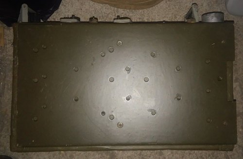

Can anyone provide a correct ID for this mounting plate?
I have seen it, or something very similar, in use on a 19-Set installed in an MB/GPW, and it also looks like something used in the 19-Set Installation in a Mk I Carrier.
I am trying to wrap my head around how it is fastened to the top of the 19-Set Transceiver Case. If it used one or both of the PSU mounting plates on the left top of the case, does that mean the right hand end of the mounting plate is free floating?
Also, in an exposited environment like the two vehicles mentioned, it would make sense for the canvas variometer cover to be used, which would be a simple enough installation. However, in an exposed environment, it would also make sense to have the Canvas Cover for the wireless set itself also installed, but can that be done with this mount sitting on top of it?
Lastly, if we can get a proper ID for this mounting Plate, can Hanno go in and correct the title of this thread to match?
Thanks,

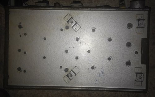

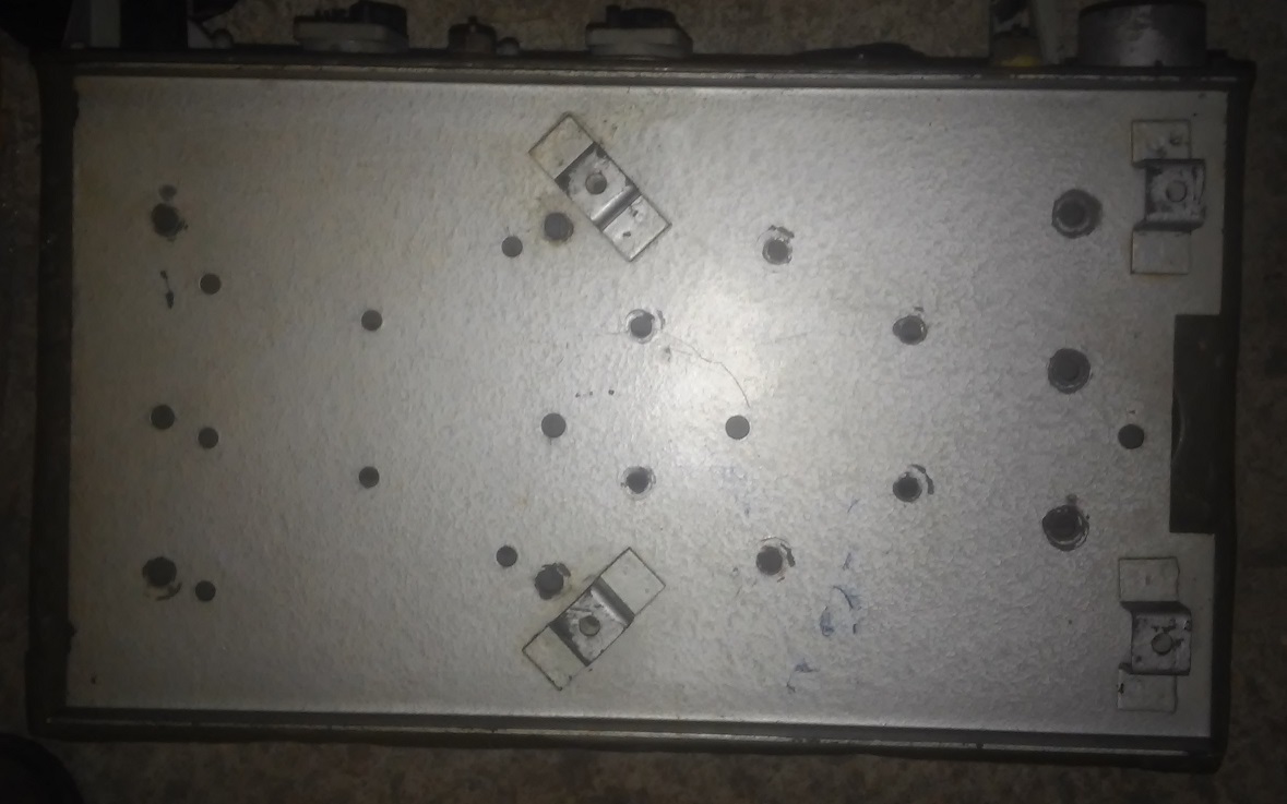

As the owner of the WS19 set pictured above I can shed some light into the plate's identification and how it is fastened to the Transceiver case. A look on the underside of this plate yields the following original description spray-painted on the right side of the plate: Plates, Mounting No. 1 - ZA-10465.
On the top of the Transceiver case are two rectangular registering plates, each comprising two sets of three holes in a V-shaped configuration. Correspondingly, on the underside of the mounting plate are four "saddles", each holding a small threaded bolt with a clever retaining ring which keeps it in place. On this example only three of the original four mounting bolts remain, so at some point one of the bolts was removed and never replaced. The saddles with their extended bolt heads register perfectly with the middle tapped hole in each of the four mounting hole groupings. It's a simple operation to hand tighten the bolts into the top of the case, until the final couple of turns when a wrench would be used to firmly tighten down the plate to the case. I've also photographed the monogram found on the bolt heads holding the aerial and Variometer in place, as well as the small round black ink stamp of unknown significance. To definitively answer your question David, yes, the right 1/3 of the plate is truly cantilevered beyond the registering plates of the case.
Hope this helps,
Patrick

Ah, excellent! My plate is almost certainly a later version than that (or has been given an all-over repaint post-WW2). It's also missing all of the bolts, but now I know what they look like I can make some up to suit. The missing bolt on your plate may be deliberate - the one under the front of the variometer is difficult to access so may have been omitted (or they assembled the variometer to the plate and found they could not then fit the bolt).
The circular stamp is almost certainly an inspection mark.
Thanks for posting the photographs, very useful.

Thanks for posting your photos, Patrick. They indeed answer a huge number of questions about what we now know are Plates, Mounting No. 1, complete with their ZA-Number.
Chris is correct, the small black circular stamp is an inspection mark from whatever factory made these plates. It should say INSPEC MECH around the rim with the number of the actual inspector in the middle. For certain, RCA did not make these plates as their stamp would also have been present - another black ring with RCA in the middle.
Interesting that the underside of the plate is unfinished, other than the either cadmium or zinc plating. I think I spotted a bit of paint overspray on one of the underside edges and am wondering now if the normal state of these plates was actually plain plated metal, with no factory painting, like the Seating Plates No. 4 used to mount the variometer on the Truck and Ground Installation Carriers. I have a call into my friend here in Winnipeg to check his plate in that regard.
Nice shot of the connector between the variometer and aerial base as well. Whenever you have a chance, can you take some measurements from it for me? The diameter of the cable itself and the length end to end where it stops inside the end connectors. Interesting that two different end connectors are shown. I suspect the one at the aerial base end was a replacement at some point. It is a solder type and would take a bit more work to install. The one at the vario end is a crimp on style and, I think, another Ross-Courtney product. Probably the original factory fitting. At the aerial end, is that a small yellow collar hiding up by the end connector. Sometimes these have a part number ID in black letters printed on them but on smaller cables the ID information is usually not applied.
I was expecting the usual three BSF countersunk slot head screws to mount the variometer assembly. Interesting they went with the BSF hex head bolts, and I notice they are all the thinner hex head type, not the more common fat head jobs.
Are the four retained fasteners that mount the plate assembly to the top of the transceiver slotted cheese head screws, or also hex head bolts?
As I said, Patrick, a whack of info in your photos! Thanks again for posting.

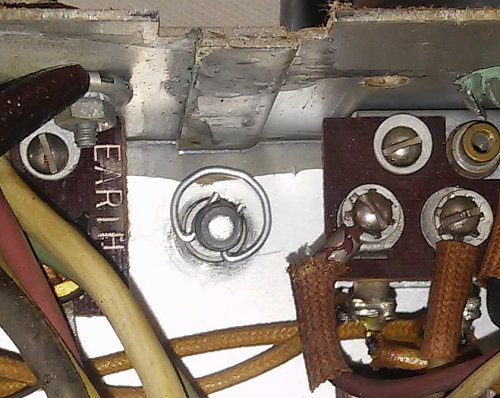

Chris: I have seen those little spring retainers on the four hex bolts BA No.2 that bolt the assembly to the top of the transceiver used with some other piece of equipment at one time, but I am beggared if I can remember what piece of equipment! Whenever you get around to tracking your Plates, Mounting No.1 down, can you spec out these four BA No.2 hex bolts for us? Total shaft length, length of thread and how far from the head the retaining clip slot has been cut?
When I think of it, it makes sense they used thin head hex bolts to mount this Plates assembly. Not enough room around the variometer to get at cheese head slotted screw with a screw driver. Would think one has to be careful tightening them, however. With the shaft cut for the retaining clips I could see the bolts shearing easily at that point if you had some knuckle dragger working the spanner!
I suspect the retaining clips are the same as those used on the WS19 control units, and possibly the supply unit retaining screw. That may be a suitable source of patterns for the clip, although they all use "fillister head" screws.

Wireless Sets No 19, Plate, Mounting No 1.
Alas no ZA number given for this part.
That will be in the "Installation Kit List", which in your case you have not got[1].
Does your plate have the L.H. notch and duplicated hole patterns?
The White Scout Car, being an open topped vehicle would be a good use for those plates, as any fixed aerial bases could be fed from the one on the plate with a standard feeder cable (plug that simulates an 'F' rod, length of P11 cable and a spade or ring terminal). Quick to connect or disconnect, and the whole set is demountable for ground use if required.
Originally Posted by Tim Bell View Post
However, I then acquired and fitted the Canadian WS9... so the plate never got used.
I will retain the plate though as in the short term, it may be the only way I do get to mount the WS38AFV... though initially to keep things simple (and given a lack of documentation and pictures) I will only install the standard WS19 set up... and also, a lack of suitable bolts to attach it to the top of the WS19 make using it a bit harder too.
Tim
Depending on the introduction date of the Firefly, you ought to be able to fit a WS19 Mk.III with Canadian supply unit (or the U.S. Mk.II with Eicor supply unit) and dispense with the battery selector box as they can both run off 24 volt 2 or 3 wire systems.
As for bolts, I think we need 2BA set screws, and I will work out the length necessary and order some - if they're under 1" long they're only 20p each.
I don't have a lathe right now (house move and hostile ex-family) so can't machine suitable grooves to make them captive screws.
The Part 0 EMER for the WS38AFV shows a steel angle frame with what looks like webbing securing straps to fit on the WS19. It might be a fairly simple job to mock this one up. (I doubt that anyone would be in a position to challenge its authenticity, given the rate of equipment development in WW2.)
The Centurion (O.P. Tank) with WS38AFV install is definitely post-WW2, and someone on the WS19 group was recently extremely confused by a supposedly WS19HP control lead (12-pt - 12-pt with 2-pin socket) that put the amplifier onto continuous transmit. The "control" socket was connected across 12V instead of in series with HT2+ and was obviously from the WS38AFV kit (which taps 12V from the split primary of the Canadian dynamotor supply unit).
Chris.

My plate... possibly repainted?

Well after sweating bullets for a while and seeing this item go unsold, I was able to make a deal with the seller and this Plate, Mounting No 1 is now on its way here. And it only took 30 odd years to track one down.
I am beginning to suspect that when these Plates were first disposed of, the Army scavenged all related components to put back into the system. By the time the last ones were surplussed out, they were so obsolete they were disposed of with most or all fittings still attached.
The stripped plates would be a challenge for anyone to figure out if they bought a box at a disposal sale.
Now I just have two bits to find for it, an intact Aerial Base No. 10 Mk II, and that fiddly little steel packing plate that sits between this Plates, Mounting No. 1 and the wooden Variometer mounting bracket.
Old 22-11-17, 20:06
Junior Password Gnome
Location: England
Posts: 882
No, you only have one piece to find: an Aerial Base No.10 Mk.II.
The steel plate is only used for mounting the variometer on the supply unit or similar arrangements with four small screws. For this plate you use three 1/4" BSF setscrews (hex head) and the wooden/rubber/bakelite/etc. "Piece, Packing" to fill the gap between the flat plate and the curved variometer.
Much simpler.
Chris.
