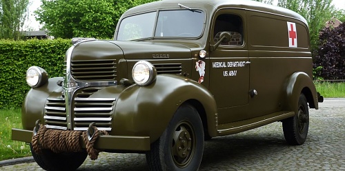

I would guess a 1946 model. Chrome trim etc. Short wheelbase 1 tonner - maybe 3/4 ton.
Here are two with the same wheels.
Name:  1946 Dodge Truck2.jpg
Size:  29.6 KB Click image for larger version
Name:	Dodge Ambulance2.JPG

Default One ton
The one ton was a popular truck to convert to an ambulance, donated from various charitable organisations and so on.
I have images somewhere of a transitional truck, with 1941 sheetmetal but still with the earlier 1939 / 1940 Budd disc wheels.
I have seen images of them in use as general hacks in North Africa and Egypt, and I suspect they did remain in production during WW2 but in relatively small quantities for essential civilian use. I have a WD 21 panel van from late 1940, after the model year cutoff, that was produced at the Los Angeles plant.
Gordon, in Scotland
