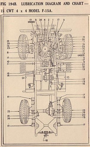

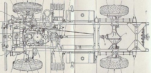

Some pictures of how /where a muffler would be fitted originally are welcome, too.
Here are top views from the manual. Am I correct that the exhaust is only supported by two hangers, one behind the muffler and one on the end of the pipe at the rear of the fuel tank?
This would be the one behind the muffler:
However we discovered I have another one on my F60S, I think you may have taken a photo. I should have taken that one off to give you, it's in perfect condition, with the remains of an original muffler by the look of it.
And this one the one behind the gas tank:
Anyway the bracket is clearly the same as the front one, sans bends, and possibly a bit shorter. There's also a support strap underneath, presumably to minimize flexing over rough terrain...? I imagine this piece would have been straight originally, and was possibly bent by a size 12 boot using the tailpipe as a convenient step!
