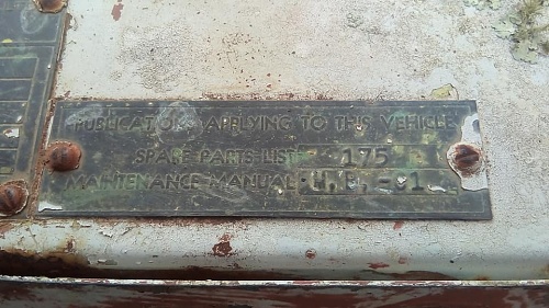

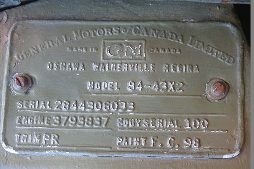

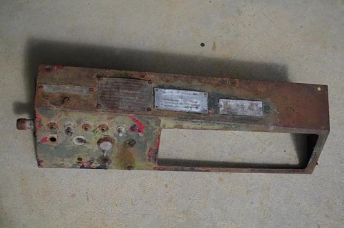

These data plates are fitted to a Chevrolet C60L, but the data plates seems to be a hodge podge - who can help to ID them?
1) First plate:
8443 denotes C60L, but what does X2 stand for?

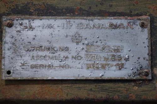

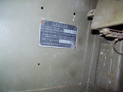

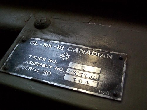

2) Second plate, it reads:
GL - MK-III CANADIAN
TRUCK no: 2
Assembly no.: ZC/C 1735
Serial no.: 164
3) Third plate, looks standard to me:

Old 01-12-15, 11:05
Posts: 14,970
TRUCK no: 2...
Assembly no.: ZCIC 1735 (or: ZCLC)
Serial no.: 164
GL must be referring to the Gun Laying radar, Mark III? (See https://en.wikipedia.org/wiki/GL_Mk._I_radar)

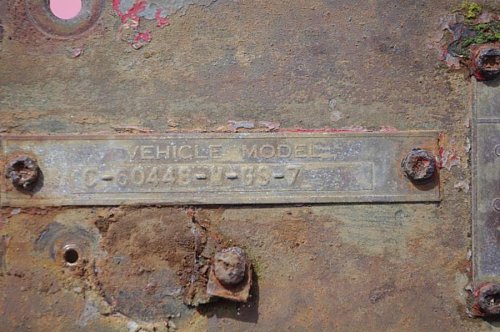

Hanno,
My first thought when seeing the data plate in the first picture was that it's an early cab 11/12 type plate, which would be out of place in a cab13...however, I am not sure when the switch from the old style data plate to new style data plate occurred exactly...it has to be somewhere in 1942.....my assumption was "simultaneously" with the switch from cab12 to 13, but there might have been a bunch of very early cab13's fitted with the old style data plate (?)
.....same question with the switch from old to new type description (8443 to C60448-M)....same time as cab switch?
Some of David Haywards research is posted here : http://hotrod.gregwapling.com/chev-t...dian-chev.html.
the 1942 8443 is about halfway the page and David mentions both Cab12's and 13's.
sorry, this doesn't answer what "X2" stands for...

Old 01-12-15, 15:58
Posts: 14,970
This is one of the vehicles that made up a GL MkIII (C) radar convoy. We have one of the radar trailers in Australia, recently converted to the site office for the Corowa military vehicle event. There were two FWD trucks with two radar trailers, and a C60L to carry extra equipment and cables, these are what comprised a convoy. I think there has been one of these C60L trucks identified in Australia. There should be a Contract number on it somewhere, all equipment was issued under contract S/M2828.
Added a better picture of the GL - MK-III CANADIAN plate, which clearly shows a REL-in-maple-leaf-logo (for Research Entreprises Limited), presumably as a sign of who converted the trucks.
The subject truck came from Norway, and is now in the Netherlands. I wonder if the plate came from another vehicle, like one of the FWD trucks which were used as tractors for the radar trailers?

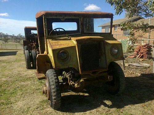

Old 14-12-15, 17:49
Tony Wheeler's Avatar
Join Date: May 2012
Location: Yarra Junction VIC
Posts: 953

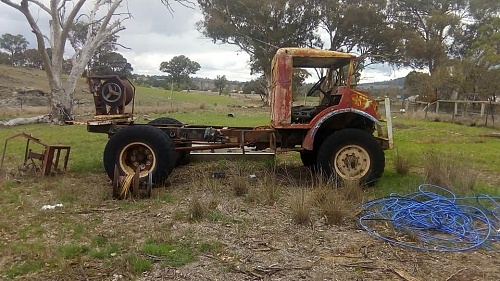

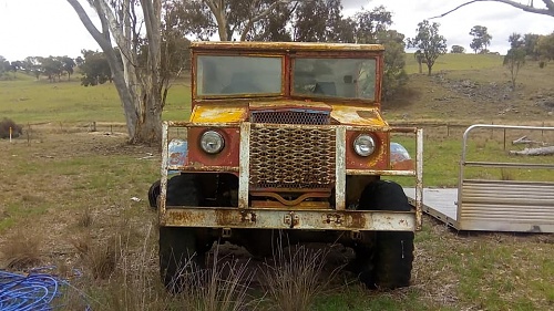

There are two that I'm aware of Richard. Both have appeared on MLU previously. This one belongs to Ghost (Robert Williams) in NSW:
The other one sits in my backyard, after I paid $300 to save it from the scrappie. See next post...

Alex, based on these two vehicles you could pinpoint the change in data plates to April '42 and chassis serial 312XXX - 313XXX.
TONY6765 - Copy - Copy.jpg TONY7944 - Copy.jpg TONY7957 - Copy.jpg TONY7930 - Copy.jpg TONY7941 - Copy.jpg
Old 14-12-15, 20:43
Thanks Tony, I did a search but could not find the post. Note on the data plate of Robert's C60, it has X2, so look like the contract S/M2828 was for the UK and assume part of it was sent to Australia.
I do wonder about the one in Norway, because if it was supplied after the war ended, my guess is it was equipment from the UK that they received. If the contract plate is present this will prove the point. UK did send a lot of surplus vehicles to Norway and this radar was probably being superseded by then as we had been developing our own.

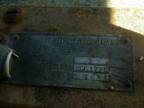

So we now have three known C60Ls which were delivered as part of the Gun Laying Radar convoy. Interestingly, the REL data plate only differs in the "Serial no.":
TRUCK no: 2
Serial no.: 164
TRUCK no: 2
Serial no.: 241
TRUCK no: 2
Serial no.: 364
Could "TRUCK no: 2" denote this is the second truck in the convoy?

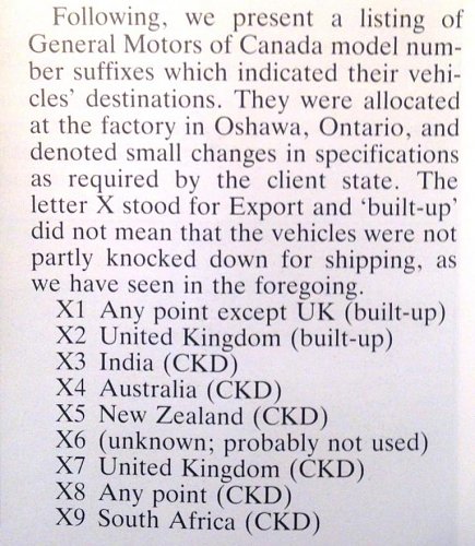

Old 12-12-15, 14:16
Posts: 14,970
Did some reading in my trusty set of Wheels & Tracks magazines, which is where I found the answer:
X2 stands for export to United Kingdom.
Would this tie in with manufacture of the Gun Laying radar, Mark IIIC? Where these manufactured specifically under British or under Canadian contract?
And if this C60L was indeed part of a Gun Laying Radar convoy, how would it have ended up in Norway? Were they supplied with the radar sets or was the truck issued as a generic GS version?
Loads of questions still to be answered....

Old 12-12-15, 17:55
Hanno,
All the equipment for the GLIII(c) radar convoys came under one Contract number, S/M2828 and I am sure this covered those that came to UK and those to Australia.
The Chev C60 census numbers for the UK were L4786091 - 4786491 and a handful with earlier numbers (same contract).
As Norway received a lot of surplus equipment from the UK after the war, it is quite likely that the C60 was part of it. The radar would have probably been obsolete by then with later types taking its place, and the truck only being a load carrier, nothing specific. Also it would appear that few Canadian vehicles were retained in British service for long, after the war.
