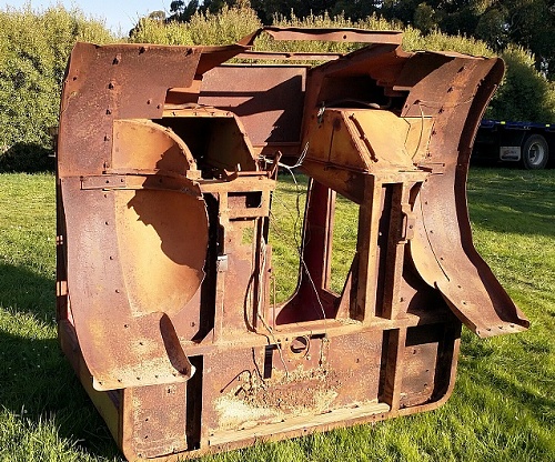

Curious that the plates are numbered "44 10193" and "4 410 194". These are the Holden body plates and there is normally only one per vehicle. These are not the Canadian Chassis ID plates, which should also be present on the vehicle. (I've saved the pictures here as photos from external sites often become unaccessible over time).
The Cab is an Australian-made "Sunshine Cab". It looks to be very straight and rust-free, and with a lot of original parts still present. Certainly much better than the average condition you will find other cabs. Is there any remains of a 5 or 6 digit number painted on the flat surfaces in front of the windscreen? This will give the identity of the truck it was originally fitted to.

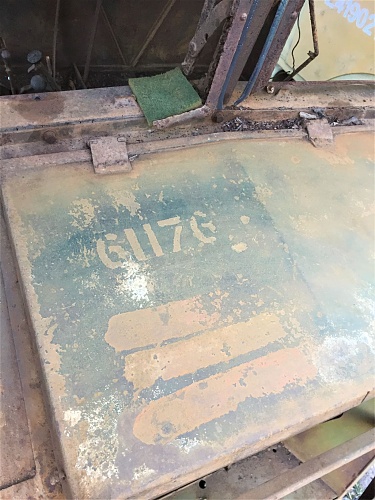

Excuse my 'dropping in' - this is number on my sunshine cab (more sunshine than cab) - perhaps Tony can shed some light?
And any significance of the Luftwaffe wingleader stripes under?
61176 was a C15A AALMG truck (anti-aircraft light machine gun), chassis number 28440023M (assembled in Melbourne)

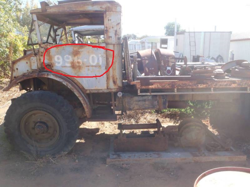

Mine has a Number on the cab Tony 996-01. I had no luck tracking it

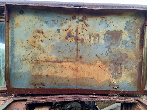

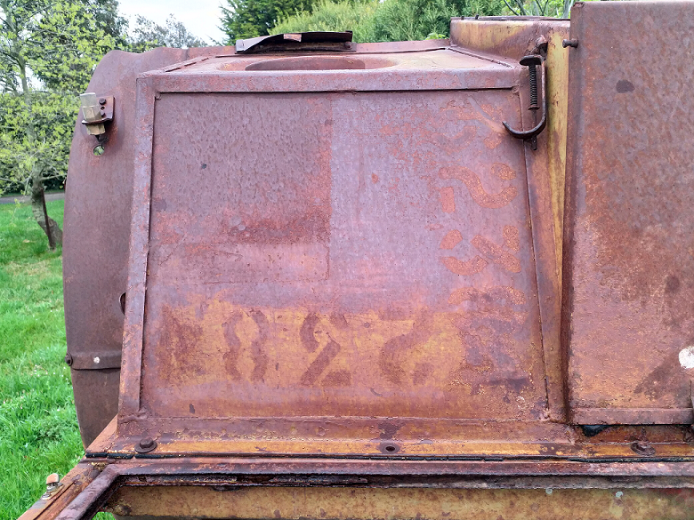

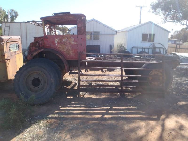

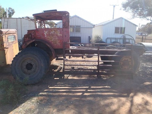

How could you possibly see a number with the sun flare Tony. You are a true Magician. Here is a better pic of the solo cab showing numbers.
http://www.astromech.com.au/spareCab.png
And Now for the tricky one ("4 410 194"):
http://www.astromech.com.au/RAAFcab.jpg
Can only see maybe 3 numbers there..
Old 16-10-18, 13:47
The "Spare" or solo cab is certainly an Army cab, not Air Force, and it is neither chassis 193 or 194. The ARN is not entirely legible to me (no magician after all ) but it is 6238x. If I was to hazard a guess I would say the last digit looks more like a 3 or a 4. Anyway, ARNs 62380 to 62389 are all Chev C15 (4x2) AALMG trucks with chassis numbers 2842100361 to ...370. Another clue pointing to it being 62383 is that that truck was disposed of to the Post-Master General's Dept, which would explain the post office red interior of the cab. Note that there is no opening in the cab floor for a Transfer Case lever.
The outline of the square was the location of the Divisional Sign. This would have identified the parent body of the Unit that "owned" the vehicle in service. As you can see it's quite illegible, but the white bar across the top indicates a Corps or Army (meaning an organisational level, not "The Army") unit, rather that a battalion or regiment. Is there a similar square on the RH side with any detail showing? The RH side would have shown the Arm of Service and identified a specific unit.
I've flipped the pic to read it better.
Old 16-10-18, 13:55
The numbers painted under the bonnet were an aide to any mechanics servicing the vehicle and would display the model number and year of the vehicle, and sometimes the make of truck. So we would expect to see something like "CVT 8444 1942" or "8421 1942". These numbers do not identify an individual vehicle, only the type. This was an Army practice, not RAAF, so despite the hint of blue paint, this was most likely an Army truck. Does the spare cab have anything similar under the bonnet?
We are sad, sad individuals here, and would like nothing more to see some other pics of this second truck.

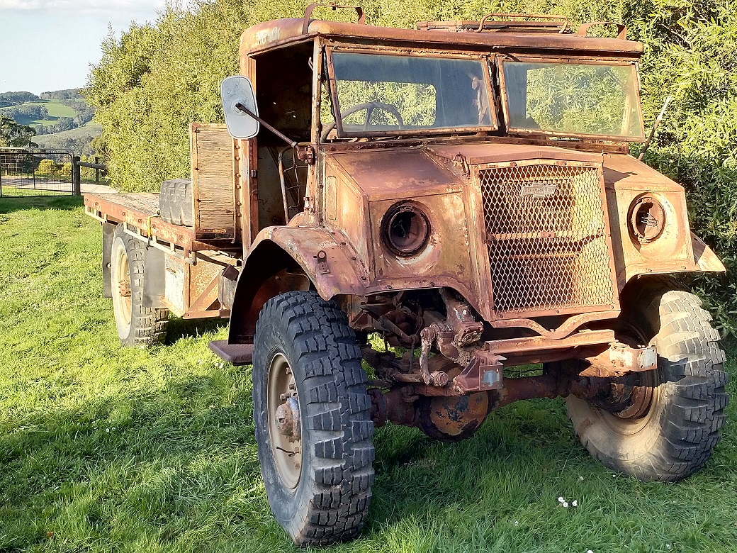

This first Pic shows the Army Number 996-01
http://www.astromech.com.au/Number.jpg

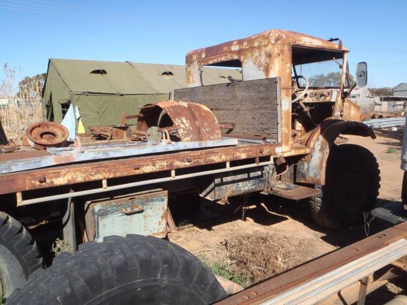

This angled pic show the truck with the Number just readable on the roof above the drivers door
http://www.astromech.com.au/frontnside.jpg
Side View from Back
http://www.astromech.com.au/Side.jpg
Lastly this is my second Blitz I'm debating its future
http://www.astromech.com.au/trucktwo.jpg
The Cab on its own was part of the package.

Old 17-10-18, 15:48
I'll get onto that Tony =)
That number is not in a format used by the Australian Army, or the RAAF. I do not recognise the number.
It is clearly properly signwritten, so is part of a fleet of well presented vehicles, but whose? That shade of blue was seen on trucks operated by the civil construction company Transfield, but their ex-mil fleet were more typically 6x6 GMC and Studebaker trucks. There was another fleet of pale blue vehicles associated with the Woomera area, but not yet identified who.
Good news is the tray is the original tray, but with a few minor modifications.

Dave Buckle: the number 61176 over three coloured bars on the bonnet is not an ARN, but the Unit Serial Number. The ID of the unit and the explanation of the three colour-coded bars system is explained in my book 'Australian Army Units and Unit Serials of the Second World War,' available from Virtual bookworm (unless some other Forum member has a copy handy?) Not a marking that usually survives.

996-01 on the doors of a pale blue/grey painted truck is similar to the colour, style and identification used by the Electric Power Transmission Company (EPT) who were big users of ex-military equipment including Diamond-T, GMC, Studebaker and CMPs.

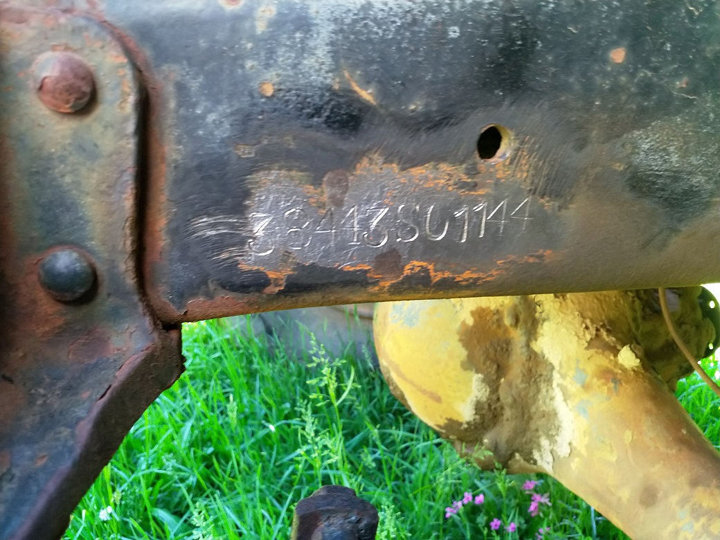

Hi All,
I managed to get the chassis number for my C60L. Here it :
Would love to hear you thoughts. Did I get it all?

From THIS THREAD:
I have attached pic of chassis number the cab came off in case it has some significance if anyone can interpret where/what that history is - seemed to be a C30A. Think it is: 33443S01115?
Attachment 102875
Originally Posted by Tony Smith
38443S is a 1943 year model (ie likely built 1944) C60L (158" wb) assembled in Sydney (GM-H plant at Pagewood). 01115 is the 1115th chassis built that year.
38443S01144! Yours is the 1144th chassis, probably built the same week as Dave's truck.
