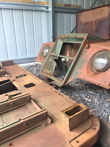

I bought this vehicle out of a shed where it has had either new or recoed: engine, carby, radiator, dizzy, fuel pump, wheel cyclinders, brake lines, exhaust, tyres etc. etc. tho the cab is fairly shot.
So therefore I sourced an excellent early/mid cab and toolbox/spare wheel carrier for it with the intention to create a North Africa representation.
However I am thinking it would be more (can't think of the words) of me to recreate it as it was.

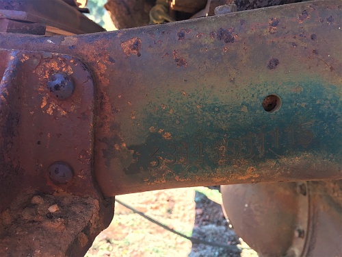

I have attached pic of chassis number the cab came off in case it has some significance if anyone can interpret where/what that history is - seemed to be a C30A. Think it is: 33443S01115?

Thanks again Tony - buoyed by what you have told me already I have attached pix of chassis number - plus pix of tags below passenger windscreen and under bonnet hoping this reveals more about this Blitz.

That's better, 8444 is the GM code for a C15A, the roadster cab is the sunshine roof. The earlier 8443 was for a C60L, or 158" wheelbase. So your corrected chassis number will need to be discovered in AWM 126 to find out it's original configuration. Most were fitted with the Australian No2 or 2A GS rear body which itself had a number of different fit outs such as Office for example.
So hold your horses on the AALMG bit - many were fitted with that mount on the LH side of the cab for a bren gun. Tony's information was based on a different chassis number.

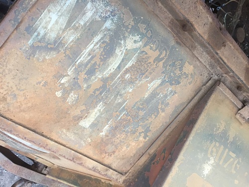

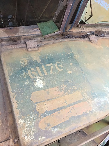

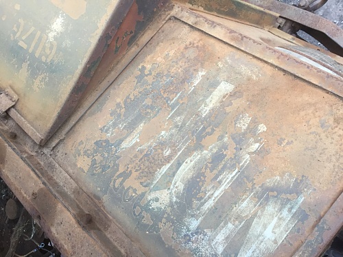

Ah, OK - so this number on the bonnet that gave Tony the AALMG info does not match what the chassis number tells us?
Name:	DH Cab No.JPG

That's right - they were not numbered on top of the bonnet - it was either side of the bonnet so the number is spurious and happened to link to a different truck.
ARN 65638 is based on your chassis number and is the correct one for your truck. At least you now know!
Attachment 102913

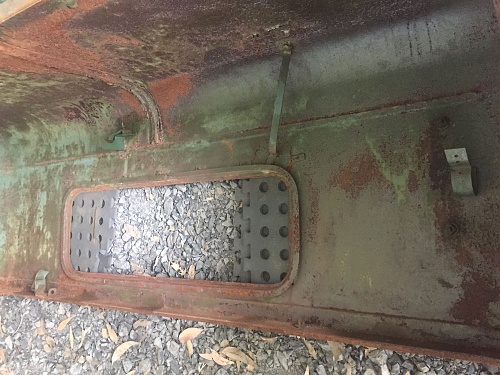

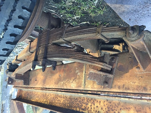

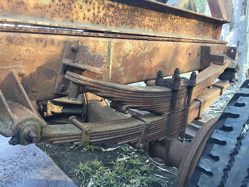

It was NRMA tow vehicle after the war - there only seems to be a couple of layers of that ...
Will have to return rear springs to original configuration - beefed up to support jib and winch.

er, why I my photos now turning upside down?!

Old 17-10-18, 23:01
I'm not going to make any remarks about where you live....

"Dave Buckle: the number 61176 over three coloured bars on the bonnet is not an ARN, but the Unit Serial Number. The ID of the unit and the explanation of the three colour-coded bars system is explained in my book 'Australian Army Units and Unit Serials of the Second World War,' available from Virtual bookworm (unless some other Forum member has a copy handy?) Not a marking that usually survives."

Thank you all for your informative input.
Bottom line is I guess: I should not feel bad about putting another cab on my chassis as I am not overriding any unique or significant history now that we know it wasn't responsible for shooting down 2 Vals and a Zeke while defending the wharf at Darwin ...

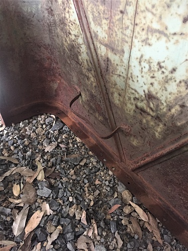

There was mention of rifle/bren storage in CMP cabs - can anyone verify the brackets in my replacement cab? (off a C60A)
It has the rifle butt holders on floor but also has what appears to be a horizontal and vertical metal loop and corresponding clamp for perhaps a bren parts bag?
Note sanded part under bonnet looking for numbers
