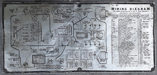

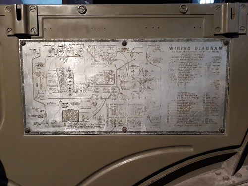

Default Ford Late Wiring Diagram
This diagram is found in our F15A and other FAT , both 1945 .
Applicable to vehicles built after June 1, 1945

With 6 switch plate in panel

Add in Waterproff distributor can look in diagram (great addition i think...)

Thanks Hanno for uploading the file.
I think this diagram will answer many questions and also create new questions.
The novelty for me is the distributor's waterprofing system.
At least here in the forum, I never read any comments about that accessory.

Thanks Mariano for sharing it. It shows the wiring of the six-switch dash plate - see http://www.mapleleafup.net/forums/sh...ad.php?t=31319

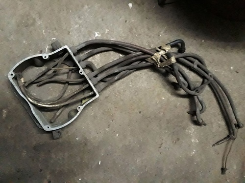

Here’s another picture of the waterproofed distributor (NMP):

Thanks Hanno!
What is the meaning of NMP ?
The wadeproof box are in this diagram

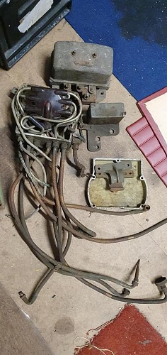

Another rare part found.... Aug 14 1945 the date.... listed on wiring and wadeproof diagram

Hi Mariano,
I revisited your diagram this week to check my wiring on my late war round gauge panel. All wire sizes agreed except one in my original harness I used for a pattern. No. 24, resistor to coil, on my harness is 16 gauge but listed as 14 gauge on your data plate. Interestingly the wire to the resistor, No. 16, is 16 gauge and the wire from the coil to the distributor is also 16 gauge. Why 14 gauge in the middle I wonder?
I was able to correctly label wires 30 and 30A instead of 30A and 30B which I used based on an earlier wiring diagram showing a voltage gauge instead of an ammeter which is used on the round gauge panels. In the case of the ammeter equipped the current goes from the solenoid, through the meter, to the battery terminal on the regulator. On the voltmeter equipped it goes directly to the regulator from the solenoid.
Many thanks again for posting it. Nice to confirm my wires go where they should and are the correct gauge.
