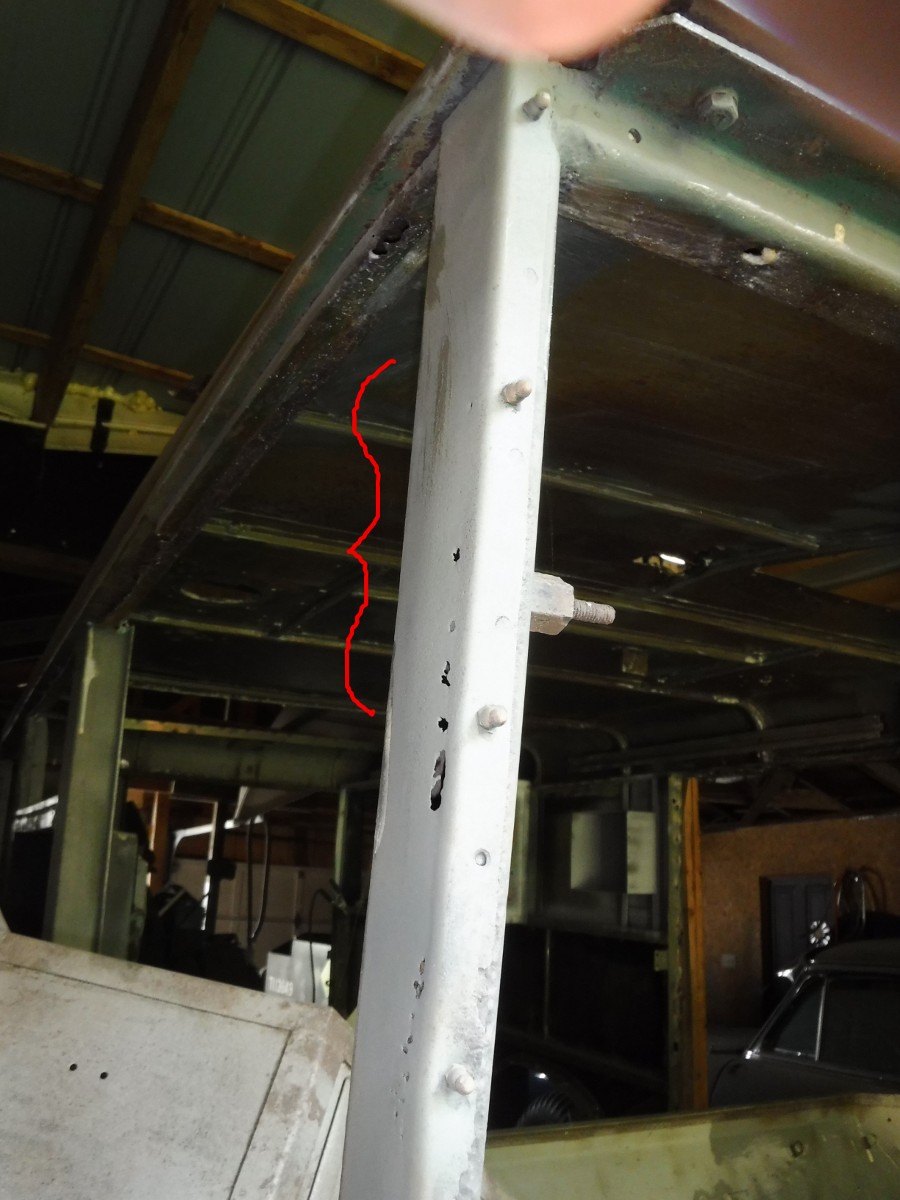

So you're suggesting both sides are flat? I hope so as it will simplify re-making them. I'll check for sand when I peel off the originals.
Hi Bruce,
I cannot vouch for Chev windscreen frames but my Ford ones are flat on both sides. Or actually flat on outside but rounded on inside as shown. They do bulge when moisture collects under the spot welded seams causing severe rust which causes the bulge as shown in the attached example.
It is the one I relegated to a roof holder.
