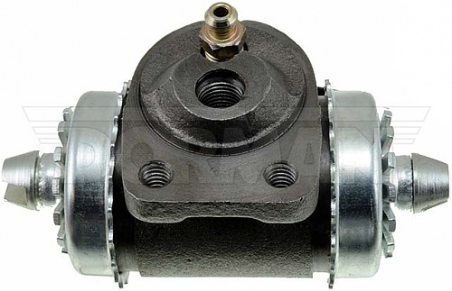

Default Rear 5450071
Rear wheel cylinder part no. 5450071, diameter 1-3/8"
Suppliers of new replacement parts:
Edited to add - note: https://www.finditparts.com/products...4/dorman-w4358 lists the following Part Interchanges:
  • General Motors 5450071
  • General Motors 5450565
  • Centric Parts 134.80027
  • Wagner Brake F4358
  • Aimco W906010
  • Coni-Seal WC257460
  • Raybestos Brakes WC4358
  • Wagner Brake WC4358

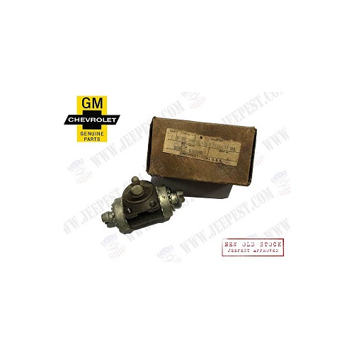

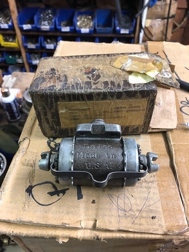

Default Front 5300869
Front wheel cylinder part no. 5300869, diameter 1-1/4"
New replacement part:
I found that front cylinders can still be had NOS - this brake cylinder is used by the U.S. Chevrolet G085 1.5-ton truck:
ID:	124925 Click image for larger version
Name:	Front 5300869.jpg
