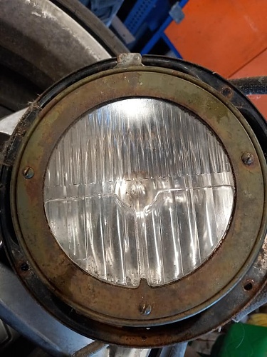

Hi,
I got this lens with my HUP and am wondering what type and what its use is. Is it missing the blackout cover, or is it some other type?
Cheers!

Marty,
I think that this is a blackout lamp that used to have a slit with a hood in the top half but a lift up semi-circular cover covering the bottom half for running under non blackout conditions.

Marty,
That makes sense. So this one is missing the blackout cover.
This also means that I have two different types of blackout lenses/covers. I also have the one with only the slit in the top half.
Thanks!

The glass lens is the remains of the late WW2 blackout shield that allowed for both blackout and headlight use with a rotating half-circle. Very useful for modern use. The other shield is the standard early shield. I have both styles available.
Old 16-04-20, 18:55
Posts: 3,721
Based on your photo, Brian, the lens in Marty’s truck needs to be rotated 180 degrees to get the headlamp portion to the bottom of the assembly and the more diffuse blackout portion to the top.
Old 16-04-20, 19:21
BCA BCA is offline
Brian Asbury
Join Date: Oct 2006
Location: Ontario, Canada
Posts: 658
David: Yes the glass on Marty's truck is mounted upside-down.

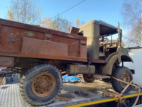

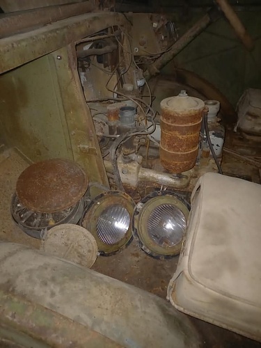

Posts: 14,974
Default Unknown headlight
This headlight surfaced when a C15A was recovered by Morten Grorud in Norway recently.
Can anyone ID it? It was suggested this is a Ford light.

Details of the subject C15A:
ID:	125542 Click image for larger version

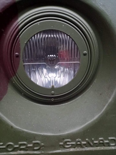

Old 29-10-21, 16:09
Posts: 14,974
Default Headlamp
Thanks Mariano, that solves the riddle!
The broad rim is what confused me.
I am see "broad rim" nr. 13061 which secures the glass nr. 13063 sits under the bezel nr. 33003-S. Rim nr. 13061 can be swapped out for blackout hood nr. 13063.
Two assemblies (C49Q-13060 and -13002) were supplied to enable an easy swap in the field.
PS: threads now merged

Old 29-10-21, 21:26
Posts: 14,974
Pics of the non-blackout assembly installed. Courtesy of Jony le Flamand.
ID:	125574 Click image for larger version
