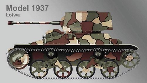

Default I have begun my carrier's transformation
As I said in a previous post I am planning on making a Vickers Light Command tank out of a beat up old T16 "Bathtub". I made the trip to Ontario to get it in a new to me truck and bought a new to me trailer to haul it back.
More money than brains I know I know....
I have wanted a tank for a long time and this seems the way to get one.
I started by cutting out left over bits from the original fire wall and engine mounts.
Blasting the interior and applying grey primer to keep the rust away.
Then on to the engine. My first choice was a Jeep grand Cherokee for its "bullet proof engine". After finding one that was in good shape I tore it apart. Getting the engine and wiring harness out was a bit of a chore. Rad was rotten so need another but heater core was good so at least I can make it warm inside.
After a few weekends of frustration I am now stuck with an engine that ran well until I pulled it. Now it won't do anything. The computer needs a good talking to by a tech more familiar with it than myself.
I am using an old standard truck transmission to reverse the drive direction so that the front of the carrier will now be the back.
I have many pics but will need to try another way to post them as they are not loading right now.
