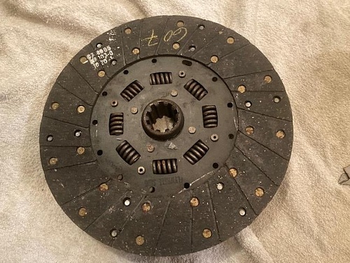

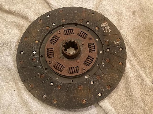

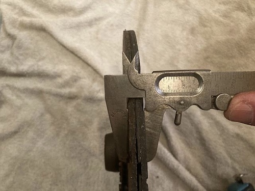

My NOS 11” clutch plate (with some storage rust, errr, patina) has a total thickness of 10 mm. The lining is 3,5 mm thick.
