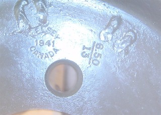

Default F8 wheels
Just thought I'd add a photo of one of my 9.00 x 13 wheels from my '41 Cab 12 F8 - Kelsey Canada 1941 - but how come it's stamped 6.50/13 and not 9.00/13? The wheels still had the (original?) 900 x 13 sand tires on them.
Old 10-03-06, 22:54
Default Re: F8 wheels
David,
The rim marking is correct for that tyre. It is the width of the rim, where as the tyre is measure on max. with and not at its beads.

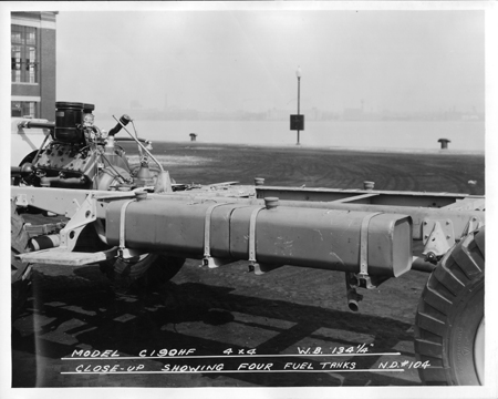

Default Re: Minor detail.....
Originally posted by Bob Carriere
In the tire tug of war picture,,,, behind the beer guzzling soldier... that cab 11/12 truck seem to have a extra long fuel tank.... am I mistaken?? did some trucks have extra large fuel tanks ...maybe for North Africa???
Just curious??.....looks like a C or F 60........
Bob C.
Didn't the Ford Factory archive pics that Clive recently had on his website show a modified vehicle for India that had four fuel tanks? That pic was taken in Libya in 1941, so it is possible it's an Indian Army vehicle.
This pic is the bare bones of an 11/12 Cab Ford 134"wb F60S.

Default Rick Cove has an interesting one
This is on a cab 12:
Link
Old 20-05-06, 04:28
Default What I would give for....
Hi Tony
Imagine some one finding a whole stock of NOS fuel tanks like that....... I might even consider giving up beer for............
....... a day!!!!
Bob C.
