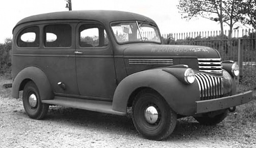

I have bought a Chevrolet Panel Delivery to take to Normandy next year. I can find no photos of them even in the background. I would appreciate anything to try to find out their uses.
I have found out a bit about production 1941-47 almost unchanged. They came with painted or chrome grille in civilian service but strangely all the military ones were delivered in olive drab or navy grey with chrome grille. They may or may not have been painted over in service.
Mine is a;
Truck, Panel Delivery, 3/4 ton, 4x2 SNL G-616
The 1/2 ton is almost identical in appearance but SNL G-612
These have nothing in common with the larger 1 1/2 ton Chevrolet 4x4 dual wheel panel truck except the rear body.
On the right is a factory photo of the carryall version of my van - note the chrome grille.
Lang

This gives me a few clues. Best I have found is a 9th Air Force "Flight Line Photographic Laboratory" - they got the film from the gun cameras on the tarmac and started developing them on the way back to the debriefing.
There is a photo of an International Metro van with that writing and the back of what looks like my vehicle parked beside it. Could be from the photographic unit or just the catering vehicle delivering sandwiches!
I will find something suitable.
Mike O'Sullivan (who drove his C15A to Normandy from Istanbul with us) is restoring the same type of Panel Delivery except his is a Dodge SNL G-613.
We are doing the work on both vehicles in his workshop in Texas then will ship together to Europe in May next year.
Any other brilliant suggestions always welcome.

Regarding the chrome, the US and Canada quit using chrome on vehicles from 1942 to 1945 since it was needed for more important stuff at the time.
Old 29-06-18, 06:14
Lang Lang is offline
Location: Brisbane Australia
Posts: 1,690
Cletrac
That was the general policy but there were many civilian model based vehicles still produced with limited chrome trimming, including the Chev Panel and Carryall. Many of the Dodges also had the vertical centre strips still chrome while the rest of the bars reverted to paint.
Here are some photos of a group of new Chevrolet staff cars in New Guinea in 1944 all with chrome grilles. The posed factory photos of the chrome grille Carryall and Pickup are dated October 42. I suppose they would have had thousands of chrome grilles in the system when the stop order came. Maybe they decided to use them on the light truck orders? Most of these would have been for US home issue or at least rear areas.

Best photo so far of a Chevrolet in use but a Carryall not very useful! It has chrome hubcaps.
Aberdeen Proving Ground 1943

The later edition of the US Military standard vehicles book lists the Chevrolet and Dodge 1/2 ton Panel vans as "Standard" . Maybe when they get a certain number in service they become "Standard"?
Here is a photo that might interest you - a gang of Dutchmen sitting on a chrome grille Chevrolet.

Reading your info on Navy grey paint instructions I always thought this Chevrolet Pick-up was an over the top restoration.
The instructions say do not paint over chrome so apart from the whitewall tyres this would be correct. But as it is a Recruiting vehicle, they dressed these up so even the whitewalls might be an accurate restoration.
Lang
