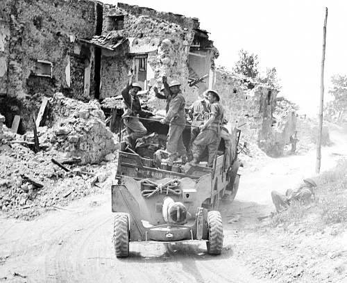

Originally Posted by cletrac (RIP) View Post
I answered my own question about the anti tank tractor. This pic of a 15 cwt pulling a 6 pounder is off Colin Stevens website. I can't tell if it's a 2A1 or 2B1 body but it's one or the other. I wonder if they used a winch on this tractor version. A higher resolution copy of this pic would be nice! The two soldiers near the front must be standing on the tool box.
Here’s a the pic which is similar to the one that David posted. It looks like it was made on the same day and location. Sad to say he is no longer around to enjoy it.
Canadian gunners with their 6-pounder anti-tank gun in the ruins of a town in Italy, c1944. (Library and Archives Canada Photo, MIKAN No. 3607615)

....it's a 2C1 type.......!!!! on a cab 13.....
Also interesting to see the wooden (?) extension on the top edge of the body.

Old 10-02-22, 18:00
Posts: 2,323
I think we have discussed these wooden extensions or seatbacks separately, can someone add a link to tha thread?

Default It looks like a full extension wooden board.......
........ the back rest would only cover the space behind the fender box..... the driver must have been from Gatineau.....think snow!!!!

........ It looks like a full extension wooden board.......
Yes, exactly; it seems to run the full length of the body, not just the "normal" small board with the two brackets.

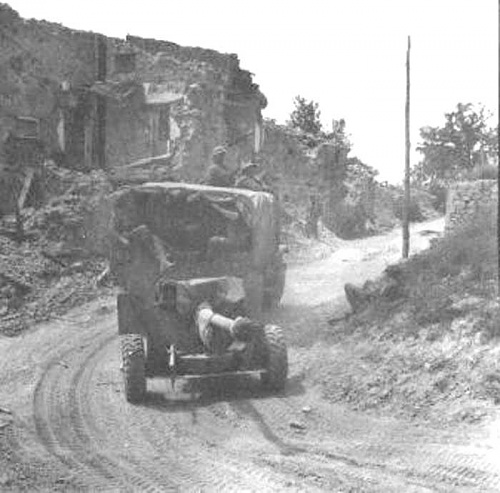

Now I just have to come up with a pic of the AAAT1 with an anti-aircraft setup in the back.
All of these body variants were used with the 2B1 bodies on the cab 12s too. In the body parts list manual it says to use the 2B1 if replacing the whole 2A1 body as it's a direct replacement.
According to the manual, the 2A1 and the 2B1 both use two long and two short U-bolts to hold the body to the frame.
Here's a photo which could well have the previous or next frame in the film:
