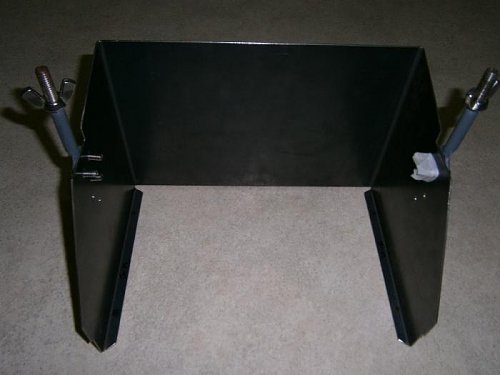

Tuesday I spent a couple of hours making a new battery hold down frame. I have altered the design a little for simplicity of construction,and hopefully it will be a little stronger as well. There will be a rubber pad running full length of both the end pieces, to protect the battery.
With it looking most likely that the chassis will not be back to me this week, I am filling in time doing some of these little jobs that wouldn't normally get done at this point. It's what I call the "little win" jobs.

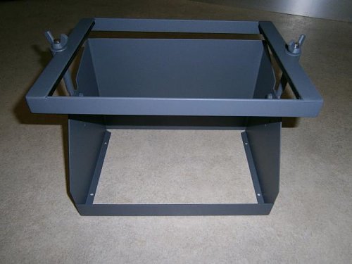

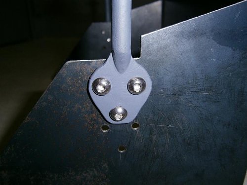

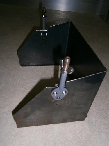

The battery box frame is back in my hands again, and it looks fairly good.
Name:	Battery box folded 3.jpg
ID:	50847 Click image for larger version
Name:	Battery box folded 4.jpg
I still have to attach the front piece. That is a job for tomorrow, as is final adjustment of the hold down bolts. In the photos you can see I have held one set of bolts in place with sticky tape for now. That probably wouldn't be sufficient for real use, so I better put nuts on too

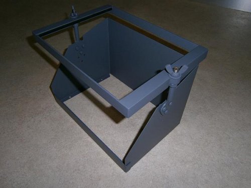

The hold down plate actually fits, yay! I made it while the frame was still at the sheet metal shop being folded, and was sweating on getting it back to see if I had wasted my time. As it turns out............I hadn't.
Name:	Battery box folded 1.jpg
ID:	50849 Click image for larger version
Name:	Battery box folded 2.jpg
I really wanted rivets, but besides the fact I couldn't find any, I also wouldn't fancy my chances of inserting them without making a fair bollocks of the job.
Name:	Battery box folded 5.jpg
So I settled for these hex head bolts. I will rough the keyway up a little once tightened in place, and they will get a dollop of body filler in the holes. Sanding the filler correctly should give the appearance of rivets!

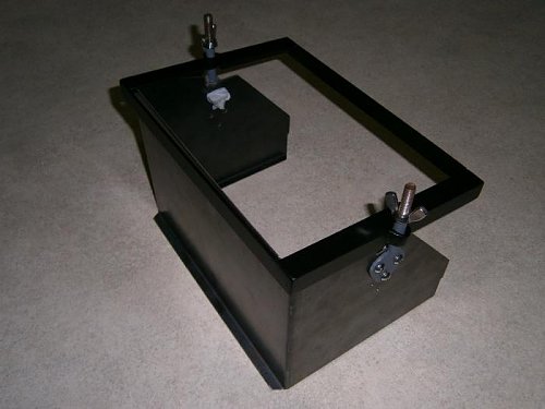

Battery box is finished.
Name:	Battery holder frame 1.jpg
ID:	50874 Click image for larger version
Name:	Battery holder frame 2.jpg
ID:	50875 Click image for larger version
Name:	Battery holder frame 3.jpg

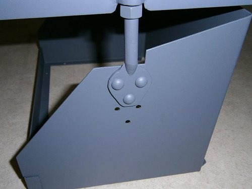

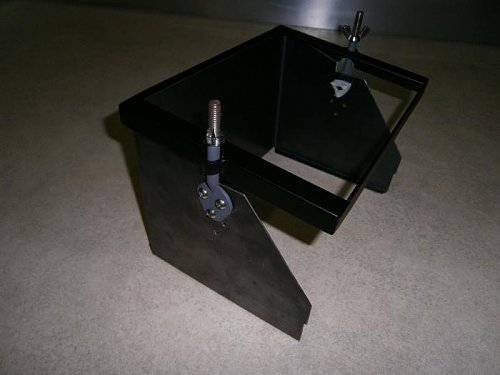

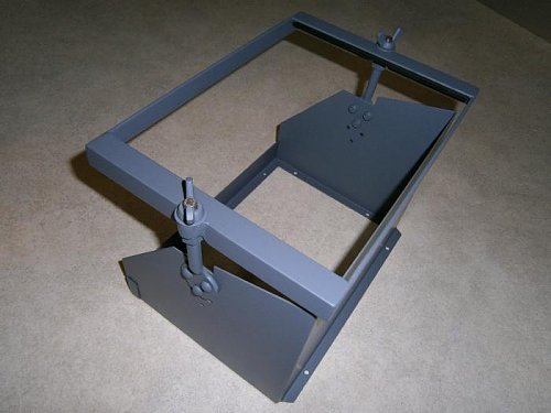

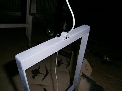

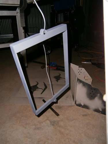

Just requires painting & it's ready to be attached to the step assembly. None of those parts are ready yet, though. Still to be blasted......apparently.
Name:	Battery holder frame 4.jpg
I'm happy with the way these bolts look with the filler added. They're not perfect, but they will do me for 'claytons' rivets.

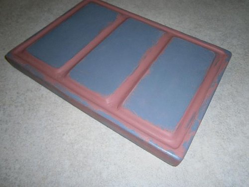

No, that's not true. I have a face like a dropped pie! And not rich either.
Name:	Fake Battery 1.jpg
As for todays efforts, nothing of great importance...again. Did get to a certain stage with work on the 'fake' battery top. The first layer of blade putty has been laid in the gaps between the three cells. There is not much that cannot be made either from scratch, or taken as a pettern from an original item. I have ordered 1x original period Ford cell cap from UK, and that will be used to make a mold for a batch of 'new' ones. The lead cell connectors can be easily made from scratch. I hope to be able to incorporate the "Ford" lettering from the top of the cap, into the cell connectors, making them look more realistic. The only thing I probably won't be trying to replicate will be the lead poles for the cables to attach to. These are easily obtainable from scrap metal place in town, so I will ask them if I can hack up a couple of old batterys to get em.
