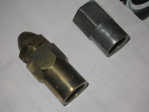

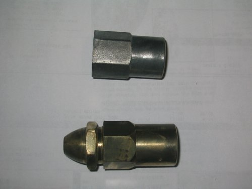

Well of course you will note that like almost all linkages on CMPs they are adjustable. What is missing from the picture though is a measurement of each one made before you disassemble them to clean them. What I now realize I should have done is laid them all on a piece of paper measured the overall length of each written that on the paper next to each linkage and then taken a picture. Which would have save me a lot of time get the linkages into adjustment when reinstalling them.

Default General progress continues on the overhaul
I'm now to the point in the reassembly of the HUP that the wiring harness, fuel lines, break lines have been all installed. One small weeper leak in the brake system of course it is the big fitting on the master cylinder which should seal OK just needs to be tightened but of course will mean bleeding the entire brake system again.
In painting small parts to reinstall I came across one brass marker light I'd heard that these existed but this is the first one that I actually seen.
Name:	HUP May 2012- 007.jpg
ID:	49601Click image for larger version
Name:	HUP May 2012- 008.jpg
