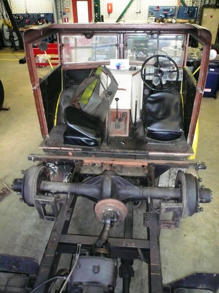

A friend of mine is working on a 1945 Ford F60L (on 16" wheels, see attachment).
He wonders if the number "SU-232454" could be the chassis number? Or could it be the frame rail part number?
He found it on the left hand frame rail, just in front of the rearmost rear axle spring mount.

Definitely chassis number Hanno. Frame rail part number is C01Q 5224 (RH) and 5225 (LH).
Front mounted spring bumper dates this vehicle to late '45. I recall Peter Ford mentioned SU prefix during discussion of Lauren's vehicle: "The CK- prefix, I assume, means "complete knockdown" just as SU- stands for (postwar) supplementary production however I have not seen any official explanation to confirm these meanings."

The F60 Ambulance as it looks since yesterday, just after the engine was removed. The engine was tested before removing it, and it happened to be in a perfectly running condition. Tommorrow I'll be lifting off the remanining Cab 13 skeleton, in order to work on it in a separate way.
