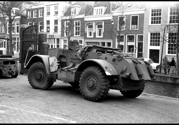

Old 24-08-04, 11:25
Originally posted by Mark W. Tonner
one mod was that the turret was removed and another was a windscreen at the front of the turret ring (ie: facing forward).
Apparently, this type of modification was carried out on more than one Staghound. The picture below shows one in service with the Dutch army after WW2. While it looks similar to Simonds' mount, it differs in quite lot of details...
...but this hulk found on an Army range in the 1980's is very likely to be the same as reg.no. 36605 shown above!

Old 25-08-04, 12:24
Default Re: Staghounds
Originally posted by servicepub
The historical report states that Simmonds had two of these converted to "chargers".
From History - 2 Canadian Special Wireless Section Type "B"
The Corps Commander was Lieutenant-General G.G. Simonds who, I felt, was as fine a Corps Commander as you could find. He was also a spit and polish general and probably felt it was a good image for the men's morale. He had taken a Staghound armoured car and had the turret removed and replaced with a wrap- around windshield and pennants and some white paint striping. The General sitting in this vehicle with a beret and an outriding escort of military police with white gauntlets and white leggings was quite impressive.
So could it be the one in service with the Dutch Army after WW2 is possibly one of Guy Simonds' Staghounds?
