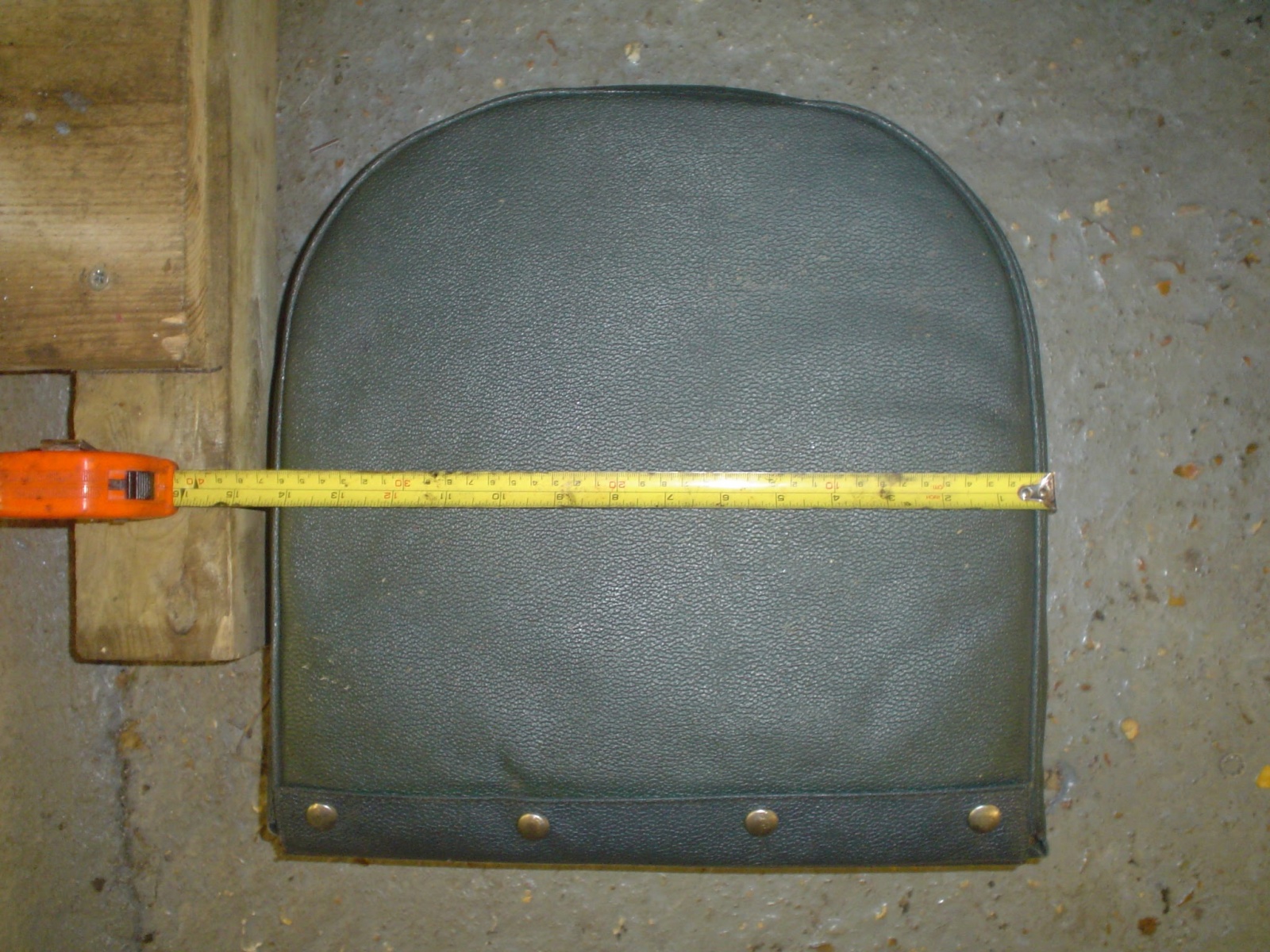

Indeed I have the 'D' shaped cushions with brass press studs and packed with layers of some type of wading material. The green (faux leather) covers are 'Rexine'
They came with over half ton of carrier spares that I bought from a well known military vehicle enthusiast and film props guy. It was all part of a haul that was repatriated from the Falkland Isles after the filming of (I think) "Evita". I've never seen the film to comment on vehicles used? Ron

Ross I've just squinted inside the flap of one of my 'D' cushions and it's definitely but faintly stamped with a TL number which looks like TL 552?. I'll look at the other cushion tomorrow. Ron
