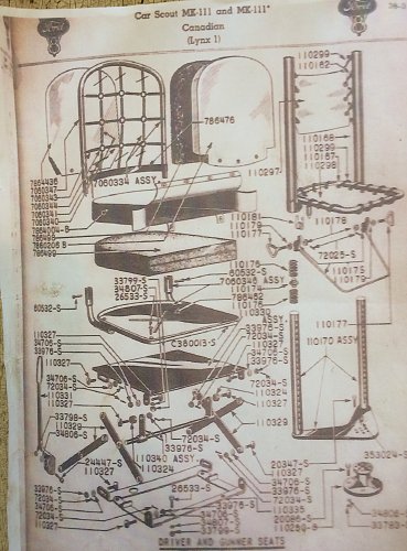

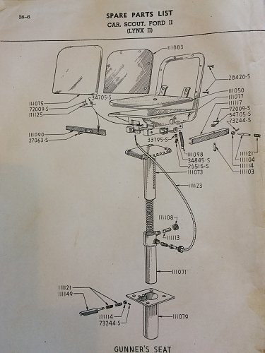

Your title certainly got my attention. Unfortunately there is quite a difference in the observers seat between the Ford Lynx and the Lynx 11.
Good luck with your project.
Peter

Hi Peter,
that's a nice drawing!
It looks like the system for the observers (gunners) seat (Mk3) is the same, allthought there might be some difference in the dimentions and the location of the lockingpin.
I'll stick to Daimler Dingo !
