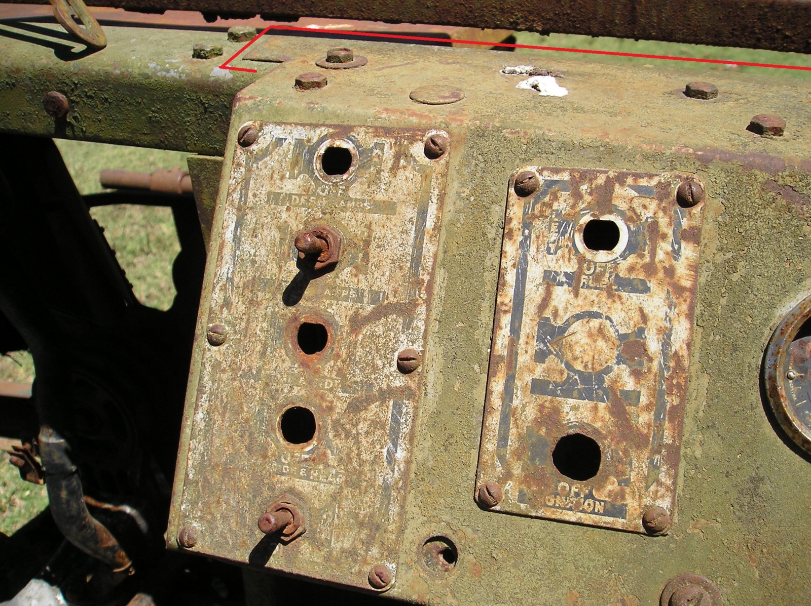

Late Ford CMPs like my FGT have a dash with a raised shape on the left side, see photo, and it appears to cover the defroster slot. Have you seen it in previous models? Any other reason for its shape?

This is the panel i have now. Because a want back to 6 volt original, need change some gauges because they are 12 volt. Some are King Sealey and some are Steward Warner

Compare two panel with different shape i question befor
