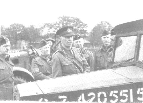

Default Photo 1 CZ 4205515
This is the sole, '38 G/S truck that came over in early 1940. It may have been serial # 815312825 D.N.D.# Z 38-1-20 that was issued to B Battery in Kingston, Ontario. This truck was photographed in February 1940 in Delville Barracks, Cove, Hampshire with a broken right headlamp and had Ontario number plates, allocated to The Seaforth Highlanders of Canada, who were brigaded with the PPCLI. Its driver at the time was Private George Kenyon.

.....great stuff guy's!! colin mentioned the ford half track/ Jeep at the cwm. attached is a photo of this vehicle which was taken by dana nield at the old vimy house.
colin..thanks for sharing Olga with us...she is a beaut!!
