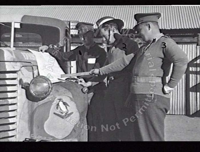

Old 09-07-09, 08:46
Posts: 6,040
Default awm
AWM piccy .......the chap in foreground liked army food
053643
